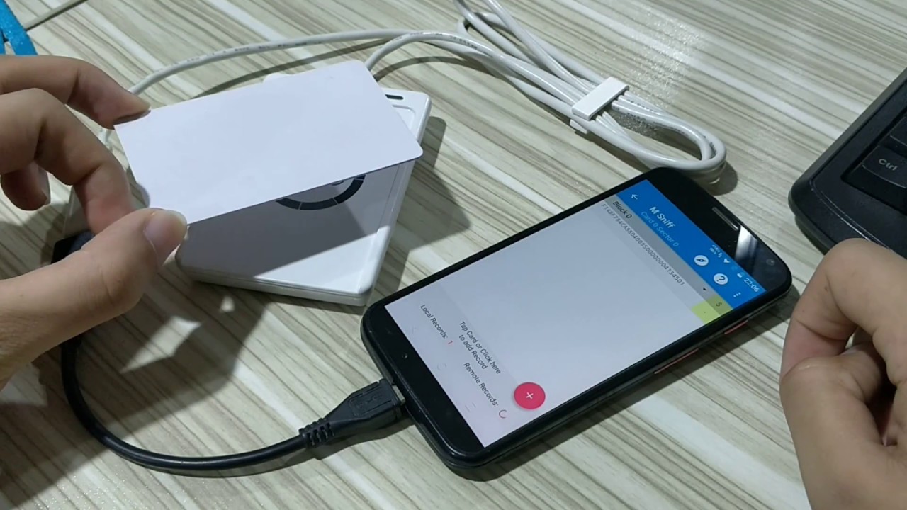

You could try this .
MCT Classic Tools would not normally write directly to your xM1 through your phone, but with an OTG cable and your ACR122U it might be worth a try
