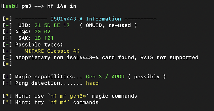

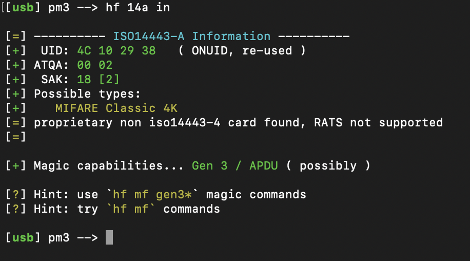

Hello all,
I am trying to clone a transport card to the same card whose UID is writable, have tried everything
hf mf gload -f /Users/myname/hf-mf-my-dump.bin
this command
also some restore commands but without success the clone all shows fails.
If I send the clone to a mifare 1 card with the command
hf mf cload -f /Users/myname/hf-mf-my-dump.bin it just copies the card.
the cards are the same but maybe I don’t have all the authorization, or I am using wrong cards. Does anyone have any advice with possibly wrong command or where I can buy the correct mifare 4k gen 3 cards writable? Thanks in advance for your help am a beginner willing to go deep

You can use hf mf gen3uid to set the UID, it looks like the rest of the card is written to like a normal non-magic chip, so you’d use hf mf restore and/or hf mf wrbl
You may also consider picking up a different gen of card which the commands you tried would work for
The transport card is the original card, and I want to clone it with the mifare 4k clone card.
I want to see if I can clone the exact same card since it has good security. Prng dectection Hard
Ok many thanks i thought gload was for 4k mifare
