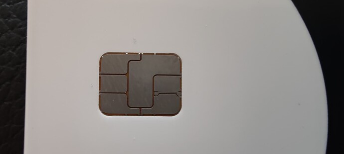

Shitty picture, but @Trefor shared that some Cash app cards are CoM
Just got a SoFi debit and it looks to be CoM as well, but a bit different than the others? I need it for another 7-9 days, after that I can try dissolving it.
Hmm yeah, I don’t think it’s CoM. It kinda looks like there’s antenna windings on the right and left side so I see what you mean, but there’s none on the top and bottom. Plus it would have to be 4 layer to route the antenna back which is just not economical, and those big visible copper planes on the right and left would interfere with the CoM coupling. I think those lines on the right and left are there for thermal relief to allow the chip to be spot welded to the antenna without presenting a huge thermal mass.
You can definitely melt it down though if you want to know for sure.
Gotcha. I didn’t see the contact points like the other chips have, but I saw the circular antenna and got my hopes up. Weird that they’re using 3 antennas on it.
It’s likely all one antenna, but the windings are routed at different positions to improve the coupling with the reader when the user presents the card in non ideal orientations, and to fine tune the Inductance
Booo
Was hoping to send it off soon.
Thanks for the info!

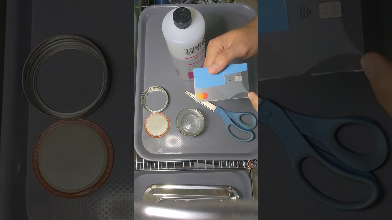

Want to extract your CoM chip faster and use less acetone? Check this out. It’s a bit more hands on–if you’d rather just wait it out and fish through the PVC soup, @Satur9’s classic method is probably the better choice.
Let’s clarify the acetone procedure. Just pour a little on the surface and let sit until dry? Multiple applications? Anything else?
Haha, yeah… Whoops.
Basically, lay it flat with chip up and put a small amount on top of the chip. Wait a few minutes and then she should be good to go. I worked on mine still wet with the rational being that as I slowly worked it loose, acetone would be sucked deeper in.
Can you expand on that? Did you use your fingers to swirl the acetone around the perimeter? Did you carefully bend the card away from the module? Both?
