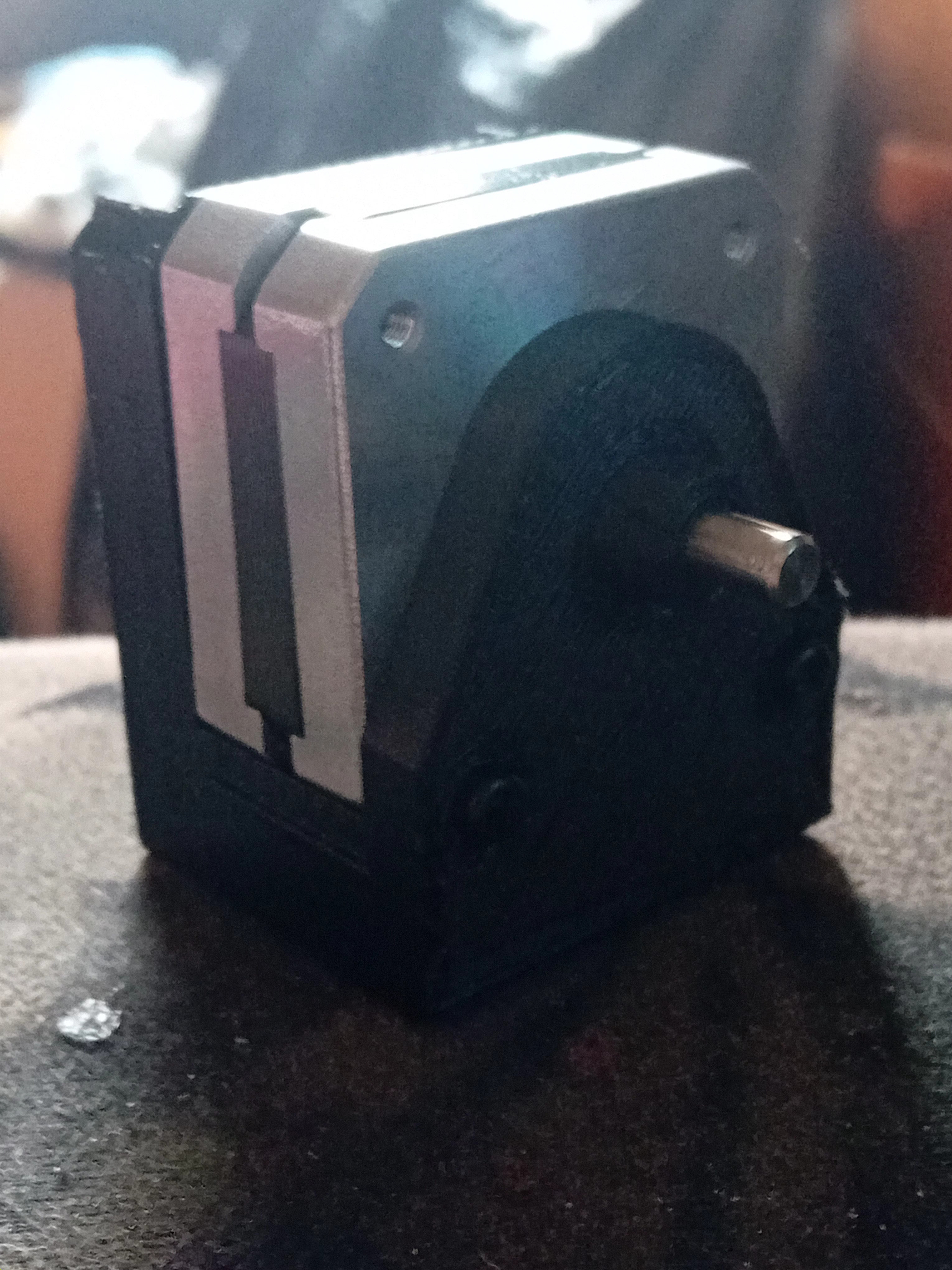

I didnt like the shape of the last case so ive shuftied everything about so i can go for a more min-amal-istic shape. So heres the preliminary design. I think I can shed another 5mm. I do prefer this minimalistic design. Bit it does mean I’ll have to redo the PCbs yet again. As I need to loose 3mm on the pcb.

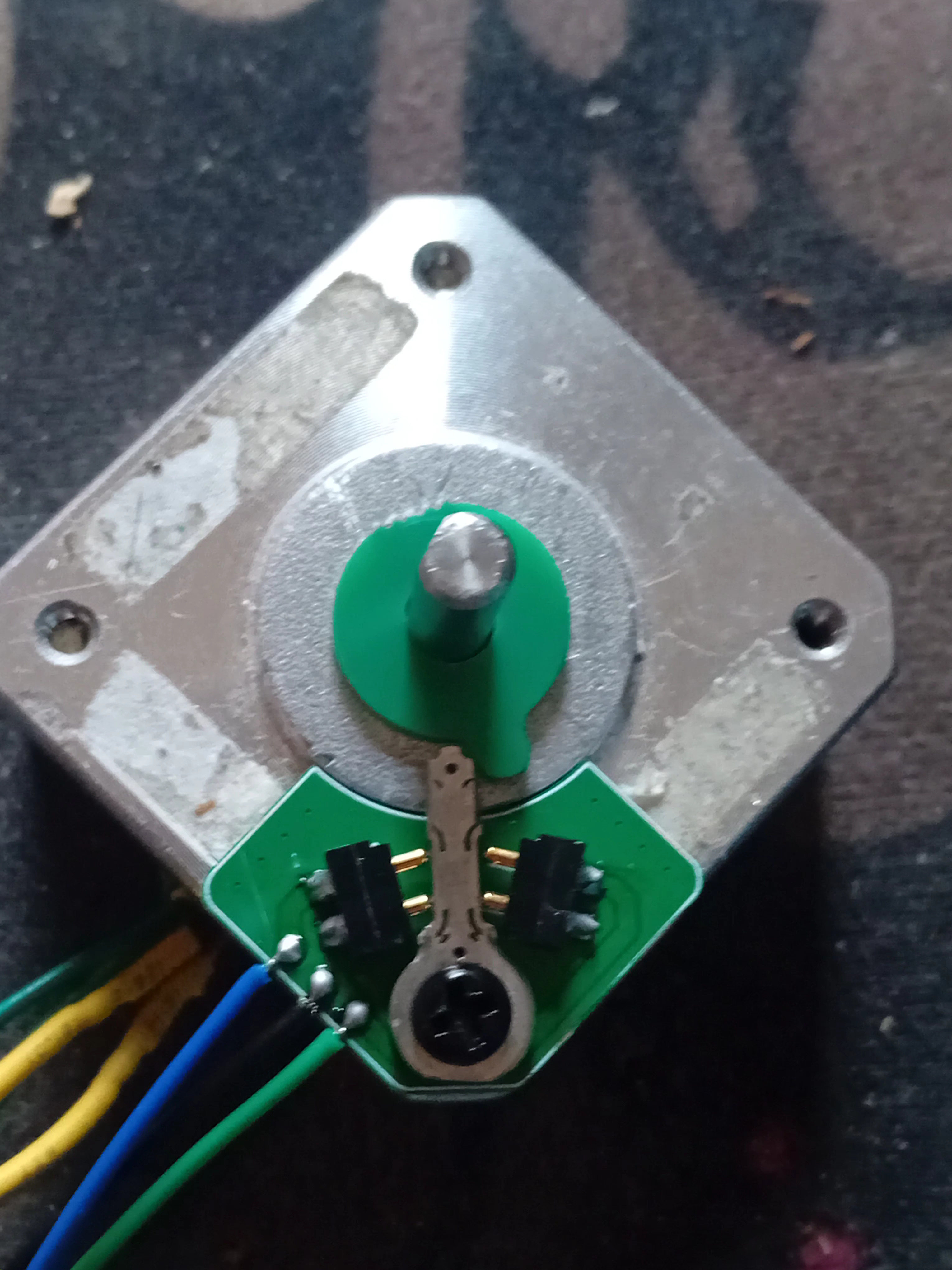

further updates, i demand it be smaller! so in an attempt to smush things even closer togeather i have done the following. i have placed the buck converter, under the Microcontroller. (shhh theres plenty of room, yes i know the antenna is in the middle of the pcb…shup!, it will work.)
i plan to make the toggle mechanism thinner (-z) by using a single 1.6mm leaver propped up to meet the pogos using a washer.(previously 2 soldered together)
idealy making the pogos the highest point. which should alow me to shave off about 2mm the top of lid.
I demand it even smaller!!
Chopping off bits that arnt needed. I will round these square edges later on.
As you can see the toggle mechanism will need redesigning… to fit the new space.
testing of the current mech works well theres enuff tollerance so there no continuity between the left and right pins in the full range of motion (16*)

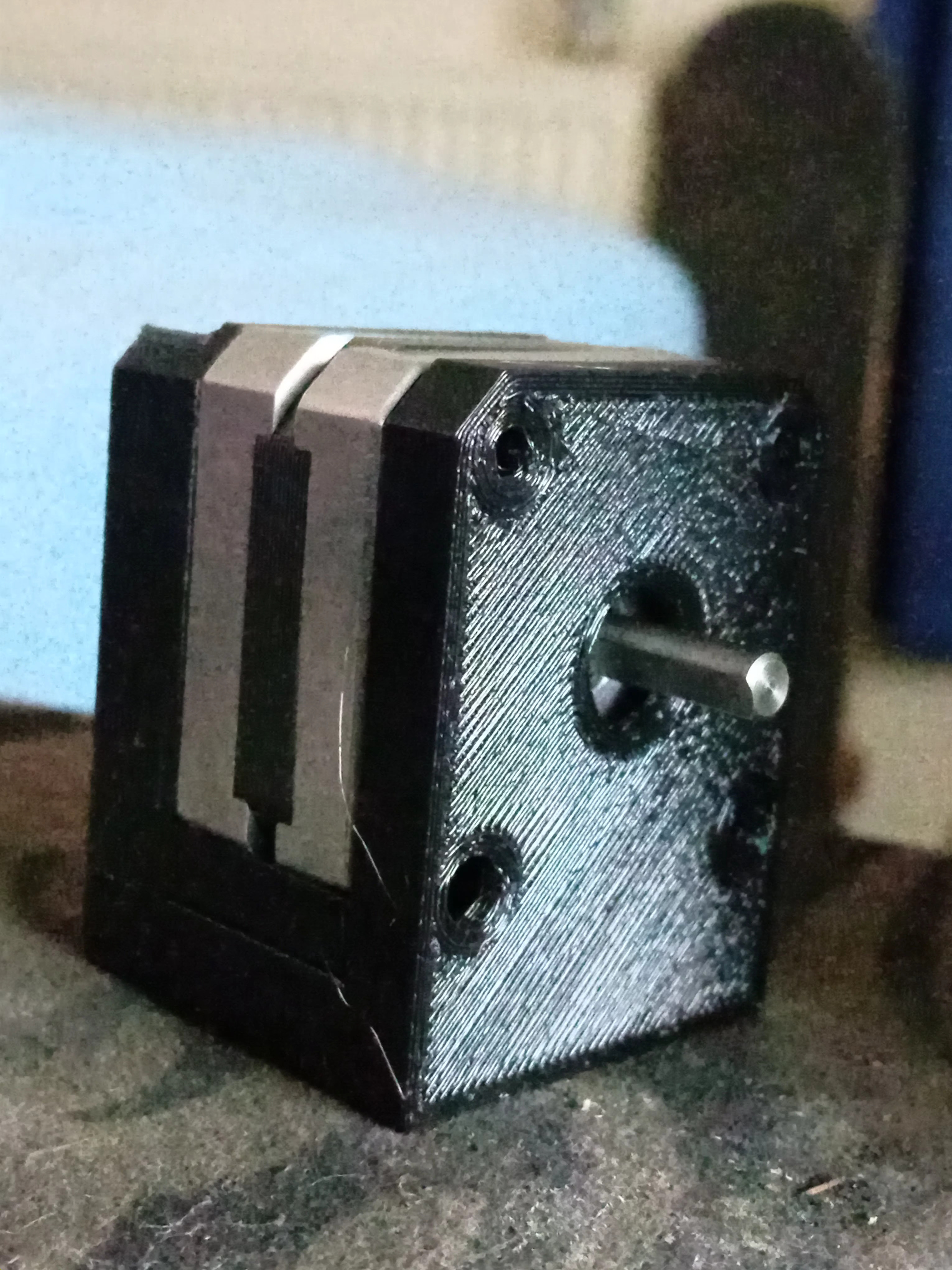

The axel needs trimming and the handle needs spraying. Case corners rounded. But over all im pleased.
I am considering moving the buck up on top next to the toggle mech. And use 90* header pins to attach one pcb to the other pcb. Making a right angled pcb. This ill alow me to.make it even smaller… lol
amended the pcb. so the togglemech fits in the case, i cba to reposition / redesign the mechanism. ill amend the case instead,

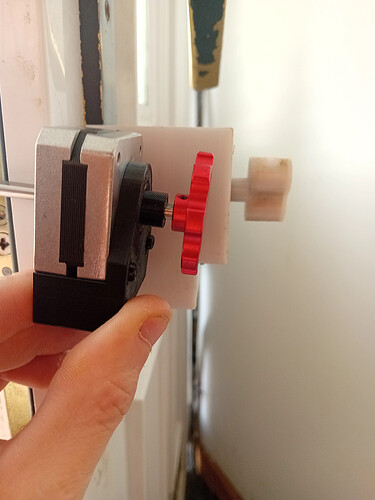

Heres a comparison. Of the 1st lock against the newest one.

In other news i am going arrange to have some vinyl stickers made. To use as electronic etching templates. Gona put the project name on the face of the lock. Just because i can. And i have a spair 12v battery.
