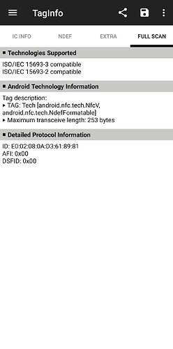

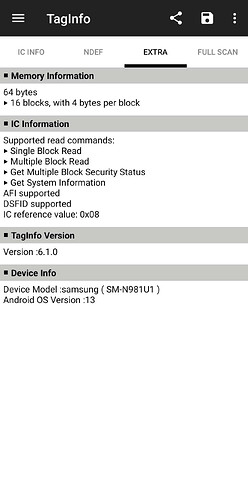

It could be user error, but I keep getting “Command failed” when attempting any of the “hf 15 raw -ac -d “ commands. I tried both options one with just “hf 15 raw -ac -d 00a0020000, as well as, everything.
I also tested the the old tag, attaching what I got.
Like that?
Yes, like that.
