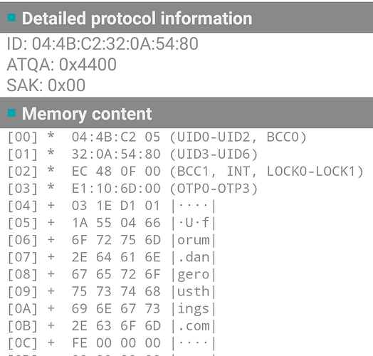

Sure! Really weird cause it shows as 888 bytes in the full scan but when writing something through TagWriter it shows 137 bytes available and the error message, even if the dataset is smaller than 137 bytes

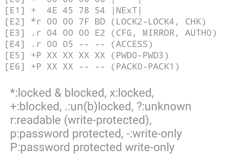

Here’s the NTAG 216 in my NExT

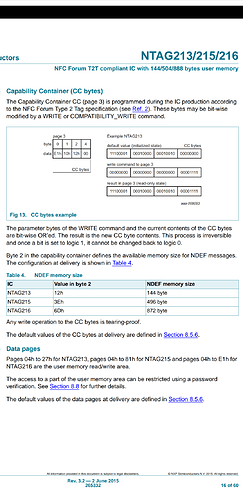

And here’s the NTAG 213/215/216 datasheet for the memory structure
Satur9
August 26, 2021, 3:08pm
5

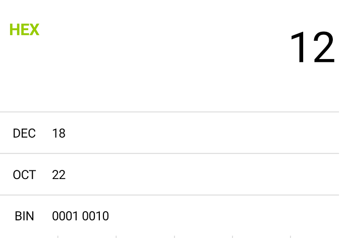

Yeah, it’s because byte 2 in page 03 is 12 on your tag
I don’t know much about the magic NTAGs. I know you can change the UID values in pages 00 and 01, but I still don’t think you can change the OTP bits in page 03. This is a question for @amal

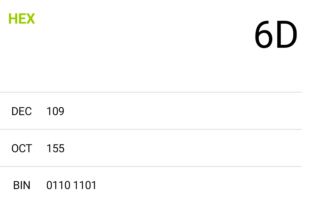

the -o parameter lets you overwrite the OTP bits.
If the tutorial is enough to get you up and running great, if not yeah wait for somone that can walk you through it, I have not actually done it myself so cant give extra advice, but it should be a good start.
if its nor working after using the OTp commands just inbox me or @ me
I could change the OTP using -o E1106D00

The raw commands:
A20400000000
A20500000000
Should wipe those blocks. NFC Tools has a raw commands option and the PM3 can send them too.
For what it’s worth, I was never able to get my flexMN to be phone-writable. I’ve experimented over the course of a few months to try and arrive at a solution, but ultimately couldn’t get it. I had success writing to it both from the proxmark as well as sending raw commands through an ACR, but phone writes always eluded success. I think @amal had mentioned getting one to write successfully at a certain point but couldn’t reliable replicate it, so it could be that either a) the phone antennas don’t provide a reliable enough connection to write the data out or b) that the nature of a magic chip is trigger an unintended response from the nfc writing apps, which are interpreting the signal as a write fail. At one point, trying to send raw commands through the phone to the chip was on the agenda to see if I could get it to write that way (as those raw commands are how I’m querying the chip on the proxmark software I wrote to write to it), but life got in the way, as it has a knack of doing.
Raw commands worked through pm3 !
Still can’t write NDEF using TagWriter “Store Failed. Format card before use”, but again no way to format it through the app.
Is there a way to write NDEF using the PM3 ?
A2060000031F
A207D1011B55
A20803666F72
A209756D2E64
A20A616E6765
A20B726F7573
A20C7468696E
A20D67732E63
A20E6F6D2FFE
That set of commands should (bit long soz ) but not sure there is an easy way with the pm3 no.
Odd that the apps are having such issues.
Really sad
I was patient enough to write a full NDEF VCARD using the PM3
Block. by. block
Aaaand it worked!
Reading the tag on Android is working fine!
I still can’t edit/write new records using TagWriter
Anyways, I’m happy that I can finally use NDEF on my flexMN !
