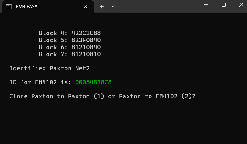

I made a python script for Paxton Net. Out of curiosity, will the output data be the same as read by Proxmark3. And everything is fine. The script is not really necessary because the same thing can be done by reading Paxton Net via Proxmark3. The next step is a script for Paxton Switch2, unless the author of the tutorial has anything against it.
txt → py
PAXTON_NET.txt (2.5 KB)
I added .py extensions to the forum :slight_smile:
Proxmark3 does the same for net2. Target automatic script. Reading blocks. Paxton identification, depending on the type, script for net2 or switch2 and copying to T5577. For switch2 I need to add a mask. This is very simple… to code. If the author agrees.
I hope Equipter won’t be angry since he released the tutorial anyway.
Paxton_switch.py.txt (2.3 KB)
oh yah idc
Paxton_convert.py.txt (3.8 KB)
----correction----

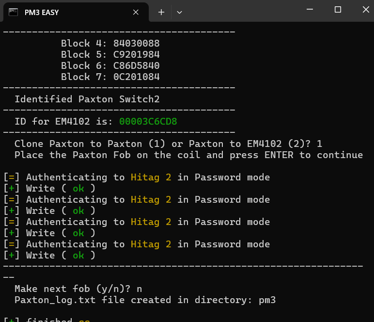

Small changes. After entering data for blocks 4 and 5, the script identifies Paxton and performs appropriate calculations for Net2 or Switch2.
I already have a script in Lua ready to read blocks from Paxton fob. The script will read data from fob and ask whether to copy it. Paxton on Paxton or Paxton on EM4102. That is, full automation.

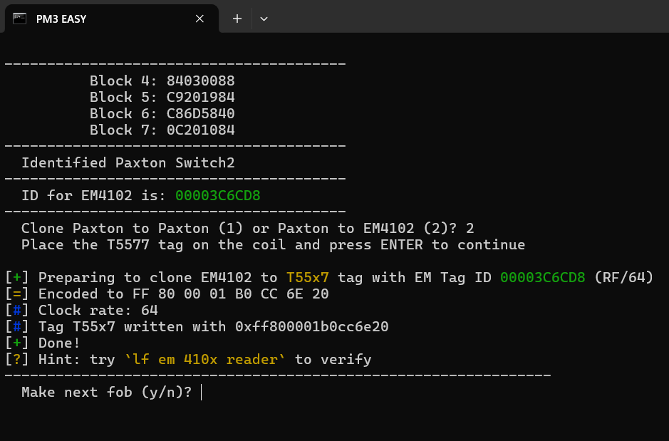

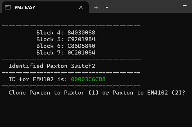

Log Date: 2025-01-18 17:23:32
Block 4: 84030088
Block 5: C9201984
Block 6: C86D5840
Block 7: 0C201084
EM4102 ID: 00003C6CD8
In case of incorrect Paxton Fob position and incorrect blocks reading, a message is displayed…
Adjust the Fob position on the coil. Press ENTER to continue…
I added the generated value EM4102 ID to the log file
Paxton_clone.lua.txt (10.7 KB)

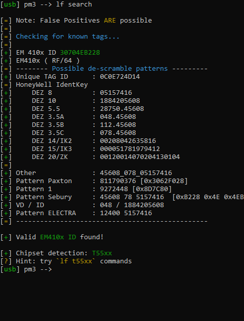

Im trying to use your lua script but the resultant Em410 or T55XX chip doesnt seem to work. Is there any way of reading the new fob to see if it had the correct data on it?
I used LF Search and got the following result:

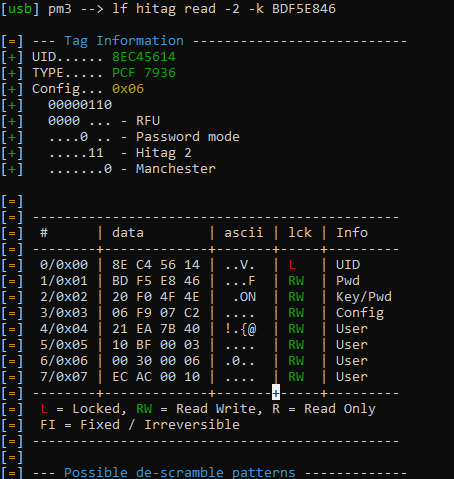

And the original Paxton Fob Dump is:
I don’t know where you got this ID from - 30704EB228???
The script works correctly. If the data from the blocks was read incorrectly, the calculated ID for EM4102 will obviously be wrong.
Based on your blocks, I made a copy of Paxton and used my script. The script generated correct data:
clone EM4102 to T55x7 tag with EM Tag ID 0002D5F3D6

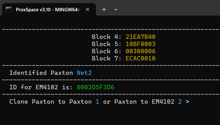

Paxton net support is implemented in proxmark3 and you do not need to use additional scripts - lf search and the result:
[usb] pm3 → lf search
[=] Note: False Positives ARE possible
[=] Checking for known tags…
[+] Paxton id… 47576022 | 0x2d5f3d6 ( C╜{ifob )
[+] Valid Paxton ID found!
[+] UID… D597D913
[+] TYPE… PCF 7936
[+] Chipset detection: Hitag 2
[?] Hint: try lf hitag commands
you run my script in proxmark 3 by typing: script run paxton_clone
If T5577 made this way does not work, it means that EM4102 support is disabled.
