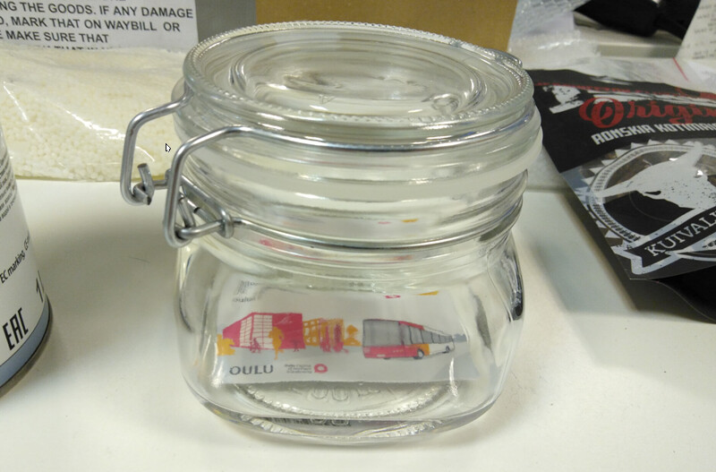

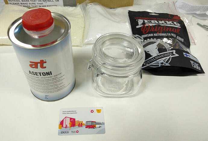

Okay, got the new bus card, spent the money left on the old one. Now I just gotta find me some acetone.
Ok so we have all the important ingredients:
  • Acetone
  • A jar
  • An NFC travel card that desperately wants to be Amalized
  • A packet of Finnish beef jerky
In it goes:
And now after a hard day’s work, I can have me a piece of jerky :slight_smile:

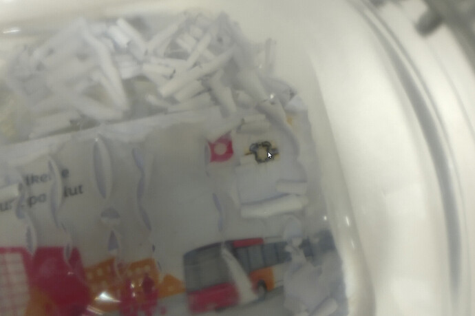

Wow it’s going and it’s going fast. I can see the chip already. I think I see copper too, but I’m not sure:
Funny, it’s flaking off into small curly flakes.
The entire circuit is free. I’ll leave it some more so all the plastic is gone.

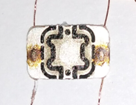

Closeup of the chip:
Amal, does this look convertible to you?
Yeah but I need to know what kind of chip it is… any ideas on capacitance? Can you measure the inductance of the antenna (without chip)?

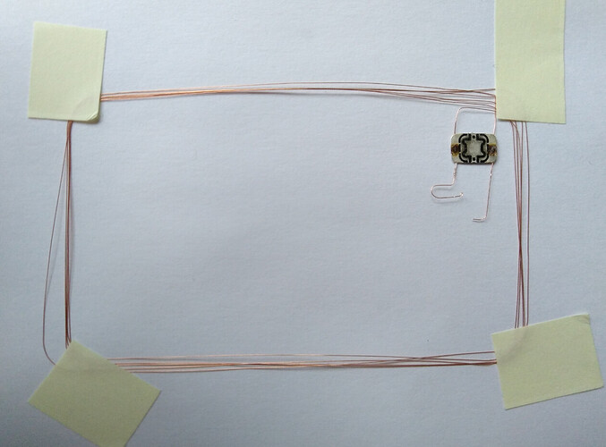

I did and it says 17 pF. But
It measures at 50 μH. That’s almost an order of magnitude off if the meter is correct. That would place the actual capacitance at 2.8 pF instead of the 17 pF reported by the chip.
So Amal, does that inductance inspire you anything?
If you don’t have a ready-made antenna, here’s what I’m thinking: I could coil one myself and test-drive it for a while. If it works well, I could either send you the complete thing ready to be bio-gooped into an implant, or send you the antenna and the chip separately if you want to do your own soldering. Would it be an option? In which case, could you give me the inner dimensions of the coil inside a wedge implant?
Meh just send the chip and coil as is and I’ll test them :slight_smile:
Okay will do.
