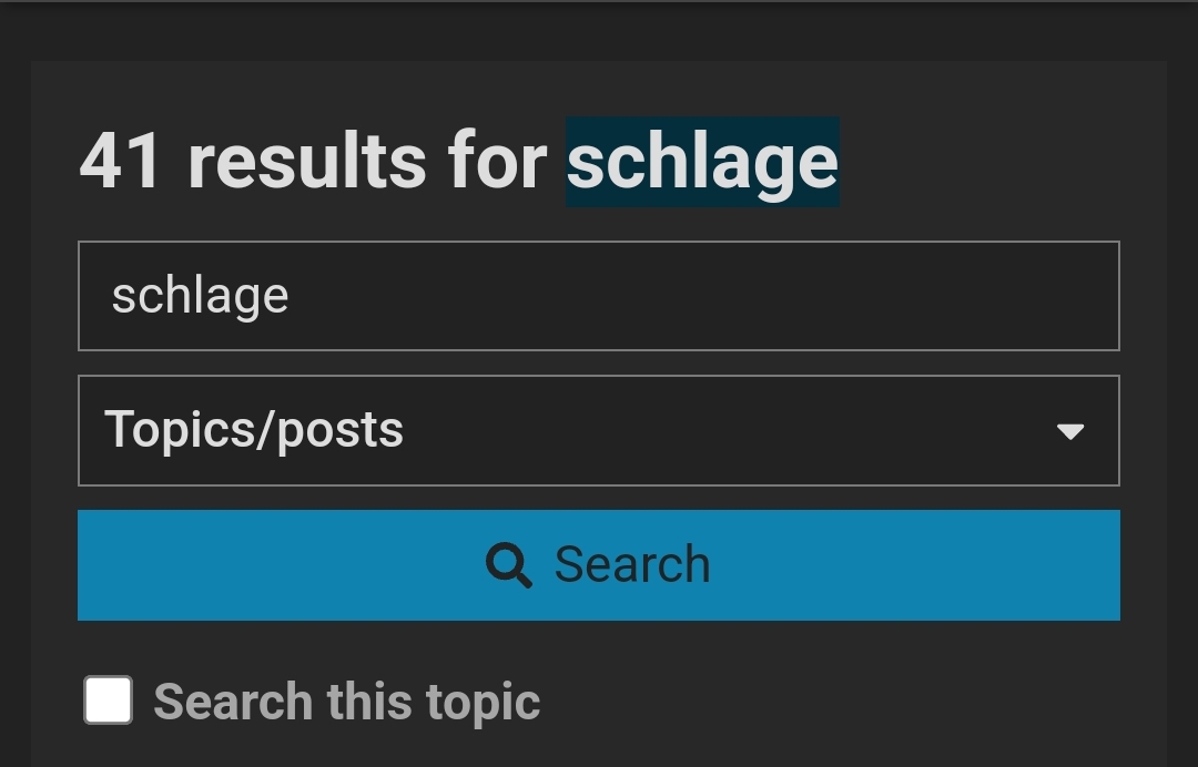

if you use the search function,
You will find a few threads that may have some suggestions for you to try.
I couldn’t find a solution using search. Do you know what frequency is the Xerox chipset ? Is it higher than 13.56? Or it could be my proxmark isn’t reading very well. What is the best way to do an update for the proxmark3 easy ?
