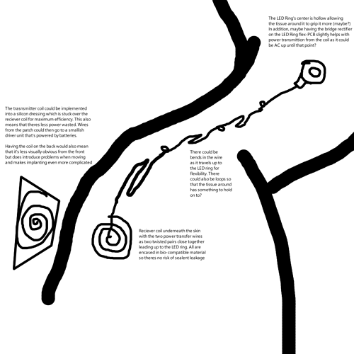

This seems very interesting! Also I’ll add a quick mockup of what I think could be done.
However, like I said earlier, the implanting process for something like this is very complicated and also as someone else said, the skin on the neck and side of the head is very thin.
I was trying my best to keep the LED Ring’s Flex-PCB one sided to keep costs down and I was thinking that the reciever coil would be an actual coil but that’s a good idea

So yeah, I was hoping that the trasmitter coil could be smaller and directly next to the reciever coil so that not too much power is required.
That massive transmitter coil takes up 12V so if it’s much smaller and is more localised, less power is needed. Also means that the driver can be less powerful and could probably run less hot too.

If the goal is the arm, and without the connection wire going through the wrist, that should be ok.
Ultimately we would be talking about implanting a flexie about 10cm long, 2cm wide at the ends. (both coils and LEDs + some wiring in the middle, all within the same encapsulation).
my right hand has a flexie almost 7cm long, more than 1cm wide at the base.
perfectly viable.
an implant about 2cm in diameter on the temple? requires skill from the installer, either way highly doable.
On the neck, we just add some (much) higher risk of rejection and migration. but still highly doable.

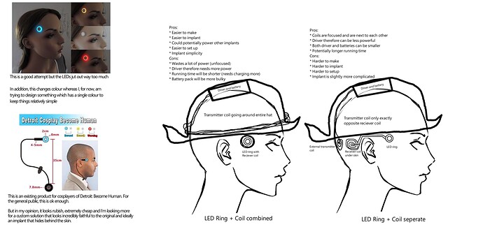

I think making an entirely wearable solution that you just attach to the skin with adhesive is a good first milestone for this project.
Great idea !!!
Yep! I’m going to start with this!
I’m certainly looking into the hat solution.
Could have a reciever coil in the cheek, nearer the jaw that leads up to the ring on the temple and abandon the neck all together as the driver could be in the hat
Maybe behind the ear?? Actually that’s much better as it could be hidden by longer hair (just saw that cheeks are a definite no go

So if you want a 2 part implant with LED’s on the temple, your best bets to place the second part are either high on the back of the head, or behind the ear.
That said, Given that you can actually use a 12V source comfortably on the hat, I don’t think a temple implant would require a 2 part design.
Just sit the LEDs directly on top of the coil!

Yep. first step for me is to get a decent LED ring, sit it on a receiver coil. slap with silicon glye to the temple, and try to light it up through a hat
Have the reciever coil right behind the LEDs in one neat coin shaped implant. In fact having the coil in the temple is perfect placement for a hat coil based on my tests from earlier.
Exactly what I’m basing myself off from!
If I have time I will make a flexible coil in the brim of a beanie with a sticky led ring just to see how much power is needed ![]()
