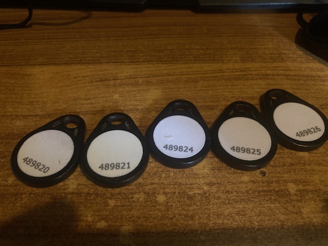

i reached this two swap bit to include operator and or xor and i dont find system for converting.
The hexadecimal is P0 UID. and all page dont find the decimal number match
- i have 20 tags hitag:
489820 0589C61D
489821 296AAB1D
489824 05AFC61D
489825 1553AB1D
489826 F267AB1D
489827 7466AB1D
it’s very hard for converting; this tag it use on system security door.
