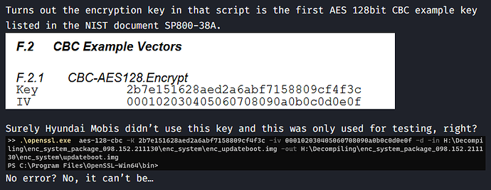

If anyone wants an interesting read, their new head unit was reverse-engineered.
It was also discovered Hyundai used a very well know for testing RSA key.
https://programmingwithstyle.com/posts/howihackedmycar/
As a rule, what we’re doing isn’t a card clone. That’s why they use JavaCard, as the card can generate an on-chip keypair and then pair that with the car, and that’s a remarkably secure way to do it as the secret is near impossible to extract when the card is sufficiently hardened (and most are as a matter of course).
Gotcha, thank makes sense!
hah! found this funny…
The Engineering Mode was secured by a 4 digit pin. This guide helped my figure out the pin was “2400”.
2400… someone there has a sense of humor. Old phone phreaks will know what this means.
… holy shit …
The RSA key was from a fucking tutorial?!
