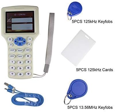

I was wondering, if I get this chip:
And this “cloner”:
Could I copy my schools access card?.

And this “cloner”:
Sorry no… the xNT is not the same chip type. The xNT has 7 byte UID on an NTAG216 and your school ID looks more like a 1k Mifare Classic 4 byte NUID chip. Also the xNT does not allow UID changes… it’s read-only. The xM1+ we had probably could have worked for this, but we do not have any more in stock and do not plan on making more.
