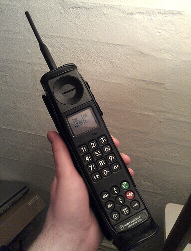

My first cellphone was a Motorola banana - exactly the same as the one in your oh-so-clever animated GIF but in black - you insensitive clod
Cost me a bundle too back in the days…
I’ll put a pin in this, and post a photo later…
Don’t bother, I’ll do it myself:
It was a very good cellphone actually. Very good battery life for the era. The only problems were: you needed Columbo’s raincoat with reinforced pockets to carry it around, and it cost you a kidney per minute to call someone.
