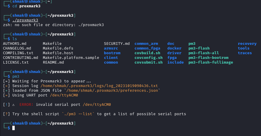

I have recently decided to move my pm3 from my windows pc to my kali linux laptop. I have done all the steps as written on github (I hope) and when I open the pm3 client it either runs in offline mode or just waits for pm3 to appear.

Did all of the above with no change, pm3 --list returns “[!!] No port found”.

Screenshot_2023-10-20_23-18-59
