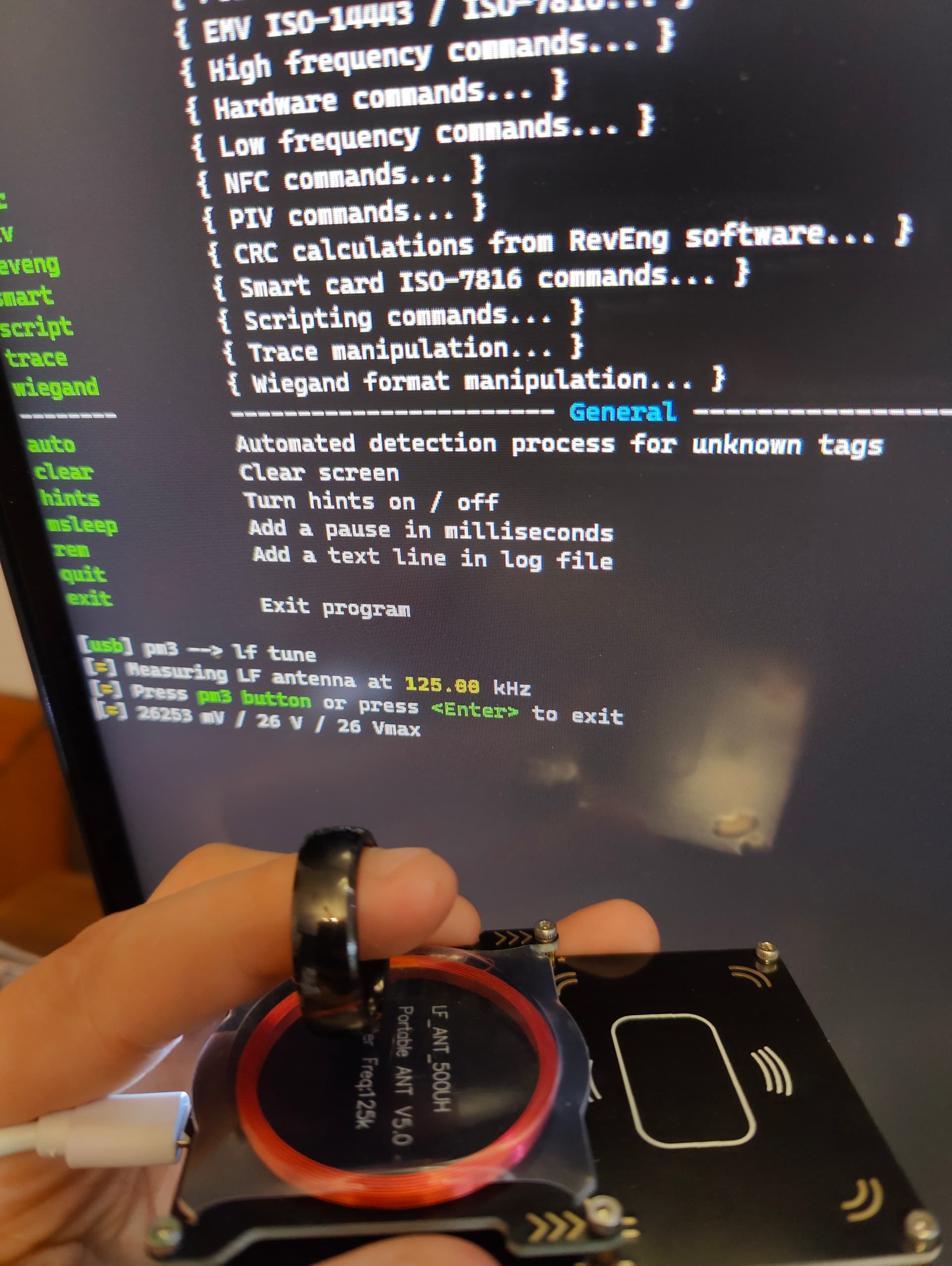

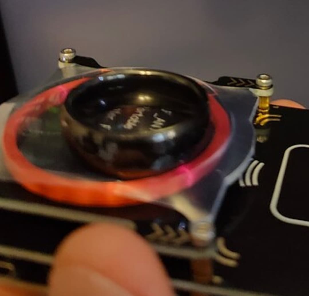

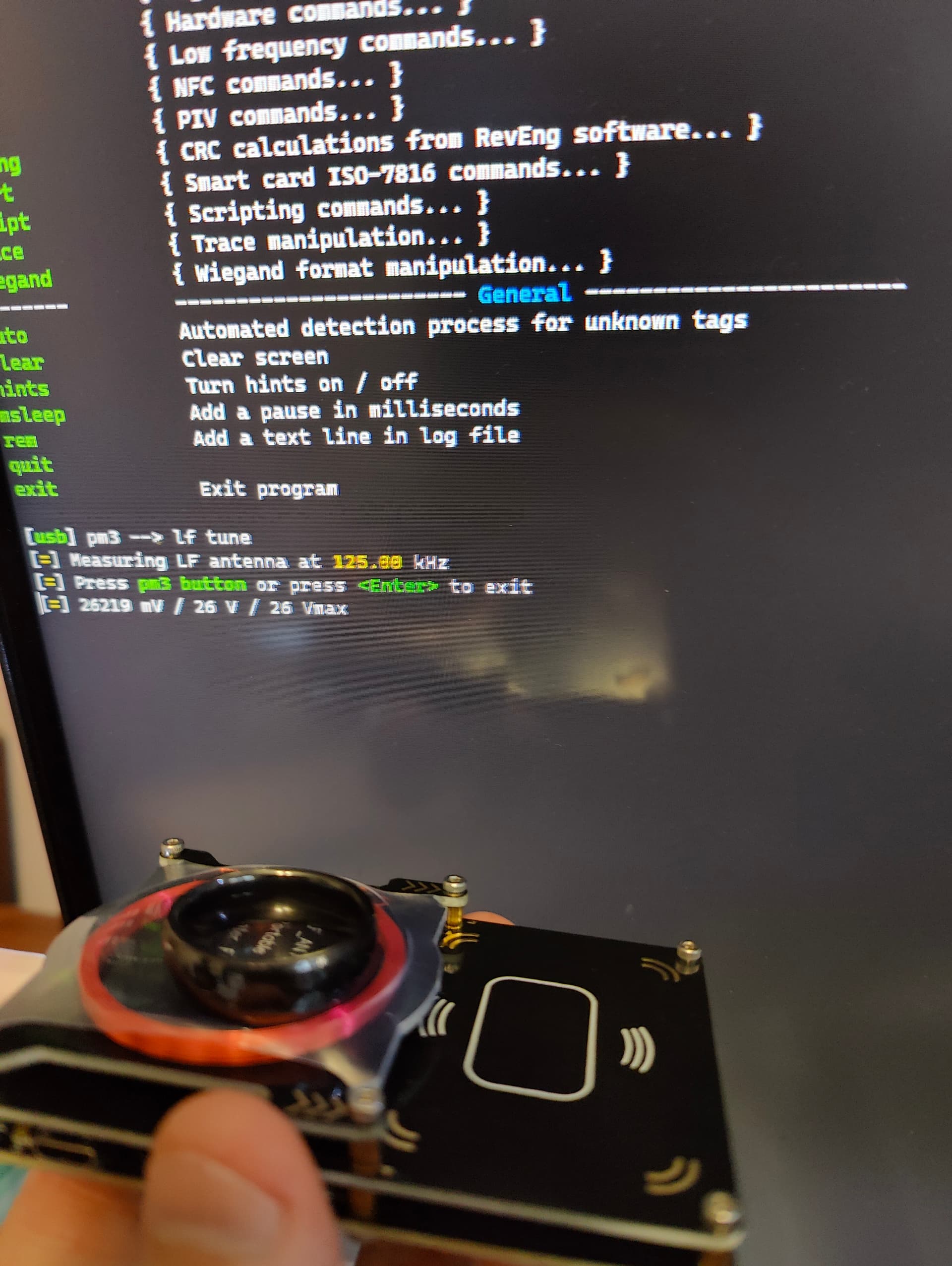

Here are some shots of the ring above the scanner with tune in the background.
Almost forgot — while taking these I realized the only reason I was getting a fluctuation the other way is because I was accidentally touching the screws holding the antenna to the board — I get the same dip with the ring nowhere nearby.
