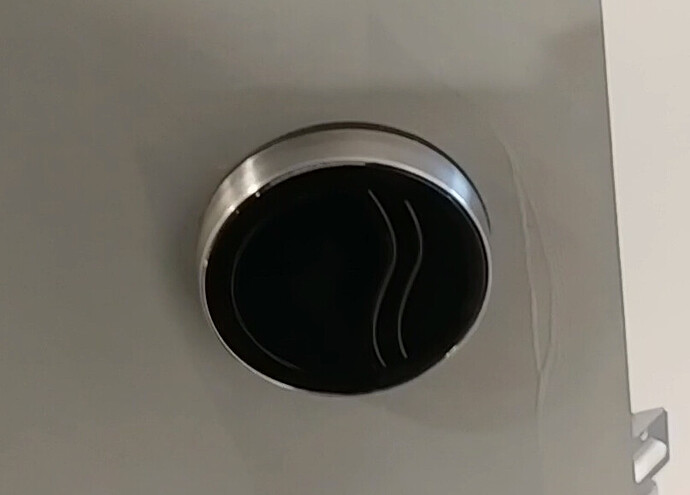

I’m not at the hotel anymore but I did grab a picture at one of them.
 ![image](https://dangerousthings-forum.b-cdn.net/original/3X/a/d/ad2ee7b4b88040f40a028dd9d883311d359021d7.jpeg)

Interesting. These are in the wall not the door? Does the door have an electronic strike?
Someone reported earlier that many of these wired readers are operating on the lowest possible voltage and performance is pretty terrible because of that. I wonder if these are similar.

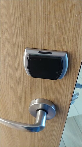

Its in the door, the reader is about where you’d expect a residential deadbolt above the lever-handle. Also about the diameter of a residential deadbolt (slightly bigger than the card width, but smaller than the card length). Though a few were on a wall (e.g. parking garage gate, elevator) with the same style circular reader.
Inside its just a long metal box (don’t have pics of that) between the reader at the top and the lever below. It also had some kind of “automatic deadbolt” thing instead of throwing a bolt for privacy you moved a small lever that didn’t operate a latch but felt more like a light switch in force required as it rotated.
Also - I just found a pic of the other style I haven’t successfully got to read a ring OR small keyfob. This was also at a Hilton property (DoubleTree), although they had the same round one pictured earlier on other doors (lobby rear access, parking, elevator, etc). Same design on the inside and same size reader but seemed more oval than circular.
 ![image](https://dangerousthings-forum.b-cdn.net/original/3X/0/8/0862cbc959a483fbf7be6de592ffc8327456c25b.jpeg)
My guess based on the 2 Hampton Inn and 1 DoubleTree locations is probably most Hilton chains have this style of lock on the rooms.

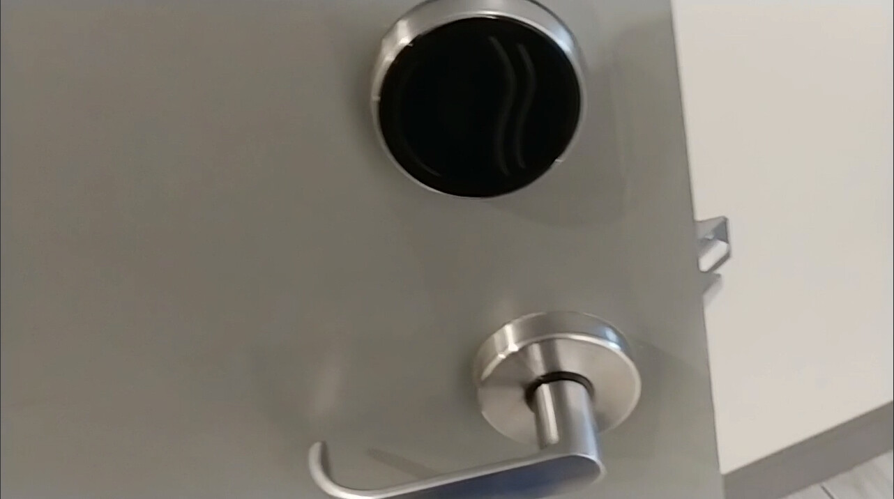

EDIT: And another picture (blurry but provides perspective) of the round reader (these do work with the round blue china keyfobs):
 ![image](https://dangerousthings-forum.b-cdn.net/original/3X/c/1/c10a29bd2ff9f438a6f7276b11714c9f0ae10cb3.jpeg)

ah ok… so this is very likely a battery powered lock and the [RDC](https://dngr.us/rdc) + ring might prove out the theory that the problem is the low power tag detection power saving approach. there are two ways to test this;
1. place [RDC](https://dngr.us/rdc) over reader, then bring the ring up to and around the [RDC](https://dngr.us/rdc) while it is still held to the lock. keep trying different positions.
2. place the [RDC](https://dngr.us/rdc) over the reader until you see the LEDs blinking, then quickly remove it and place the ring to the reader. swap it quick like this;
