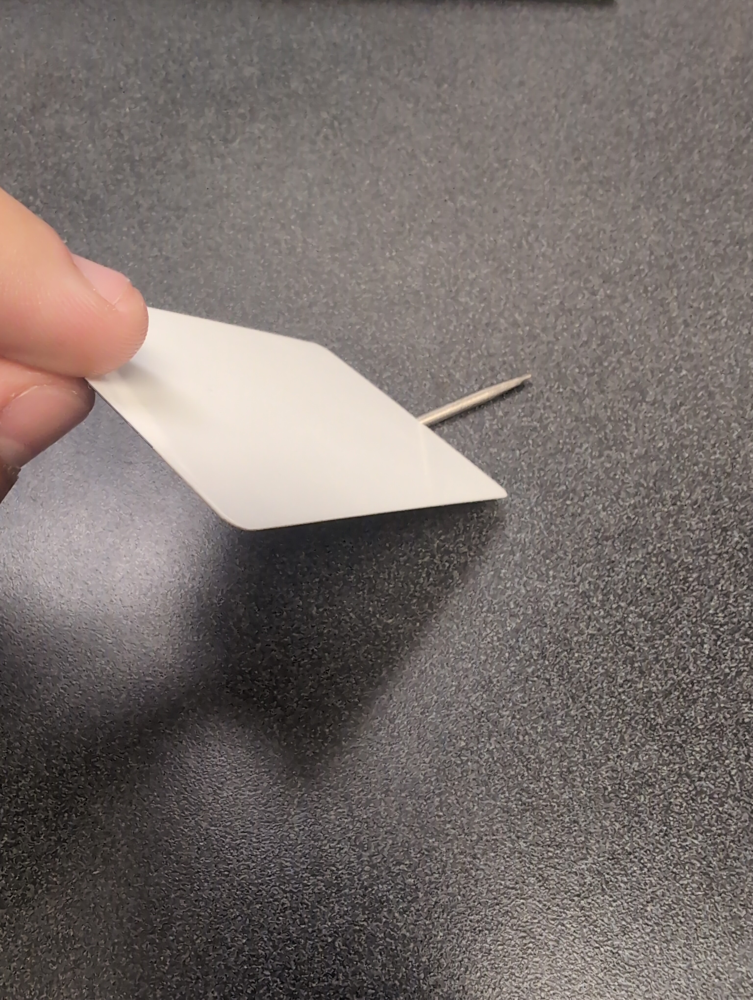

After doing some quick testing a few months ago ourselves, we (me and SO) have found this orientation to work the best when combined with a slow-drag down my arm.
My setup here is less than ideal, but this should get the idea across. Card is phone, awl is my NExT in this case. Roughly 45°
