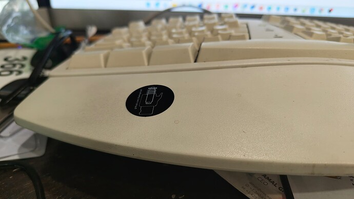

For those of you in the DT Club, you’ll know I did a project where I embedded in NFC Reader into my keyboard. Aside from making it easier to read, this sticker acts as a nice target for placing implants up to that reader.
hellofasticker you got there sir.
Might i add that my logo has officially went full circle and has found itself back on what it came from…
