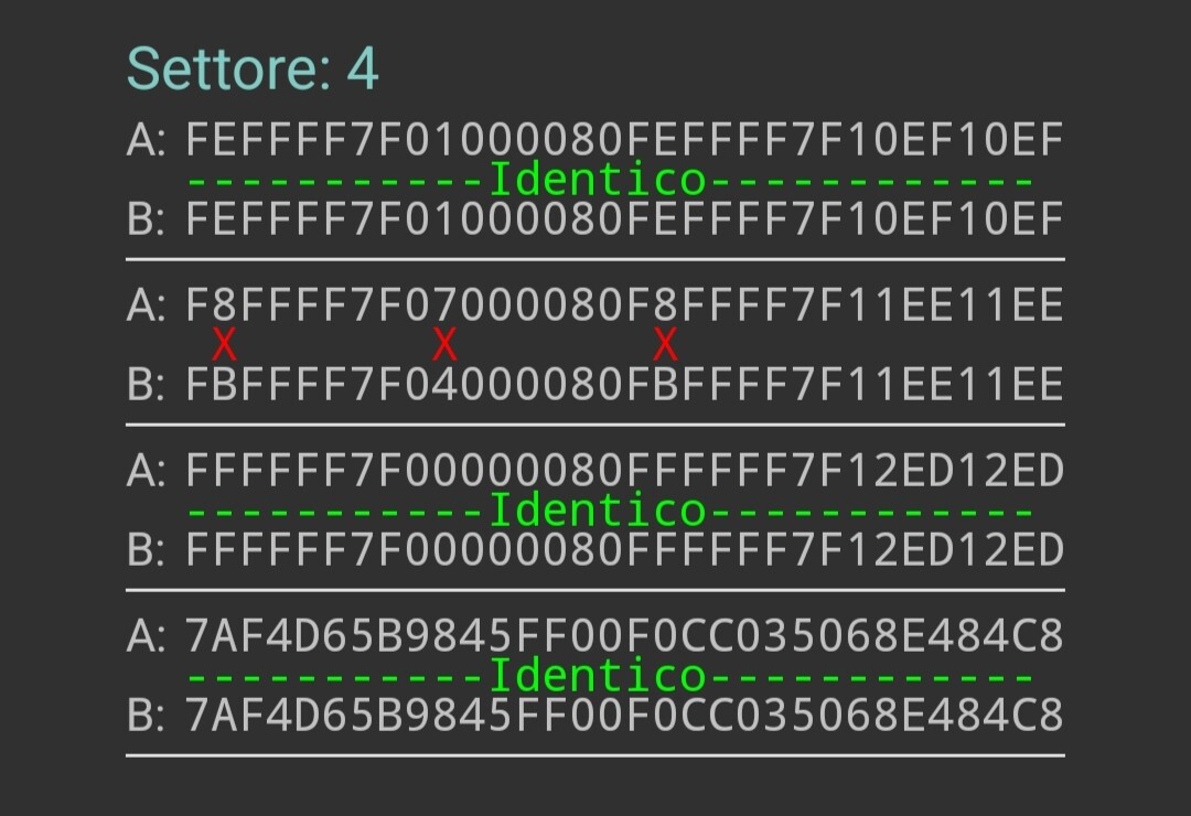

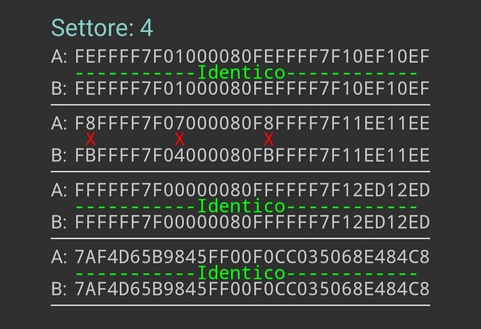

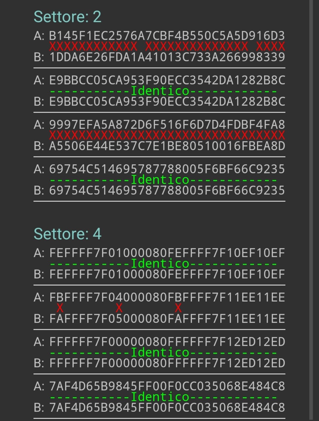

I saw similar question here so I think it’s ok to ask: I have an nfc mifare classic 1k (hardened version), Of which I managed to get all the keys by bruteforce. It’s the key to my work office, and I’d like to be able to change it. Every time I scan it, an internal counter updates, taking into account how many times I have entered (and therefore left) the office. I would like to change it to reduce the number of times I go out in a day, but here comes the problem. The number of times I entered and exited is marked in the second sector, block 1 and 2, and I can change them without any problem, but it seems that block 4, sector 2, In read-only mode. If I change sector two, writing a previous dump where I only exited 5 times, and I don’t change sector 4 the tag stops working… If you need more information just ask.
I attach sector 2 and 4, the blocks with A: in front are from the tag With some exits, while those with B: for the new tag.

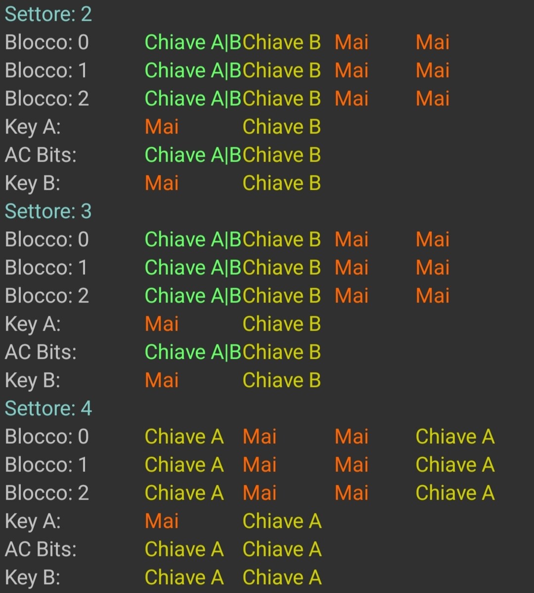

Here also the permission, it’s in Italian so here a quick Italian lesson: mai means never, chiave means Key, blocco means block, settore means sector.
Edit: I entered my office once more, here the change in sector 4
Seems like that it’s going backwards, from c to b to a to 9 to 8 and so on, but the one character in the middle I have no clue
