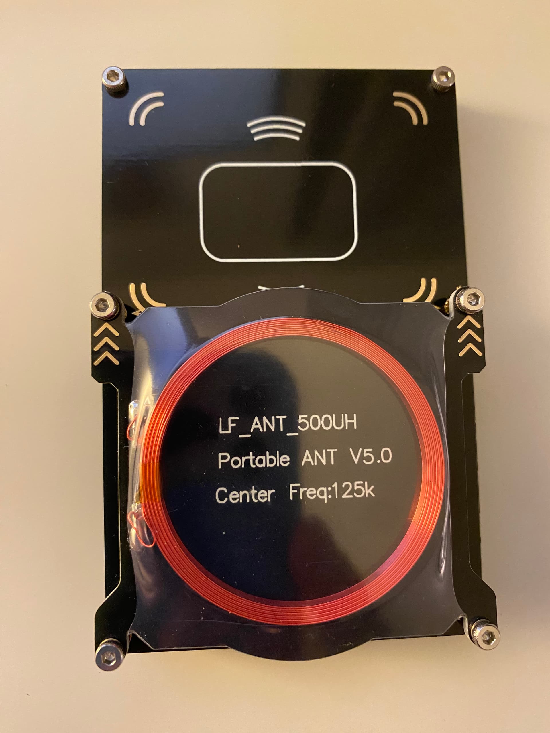

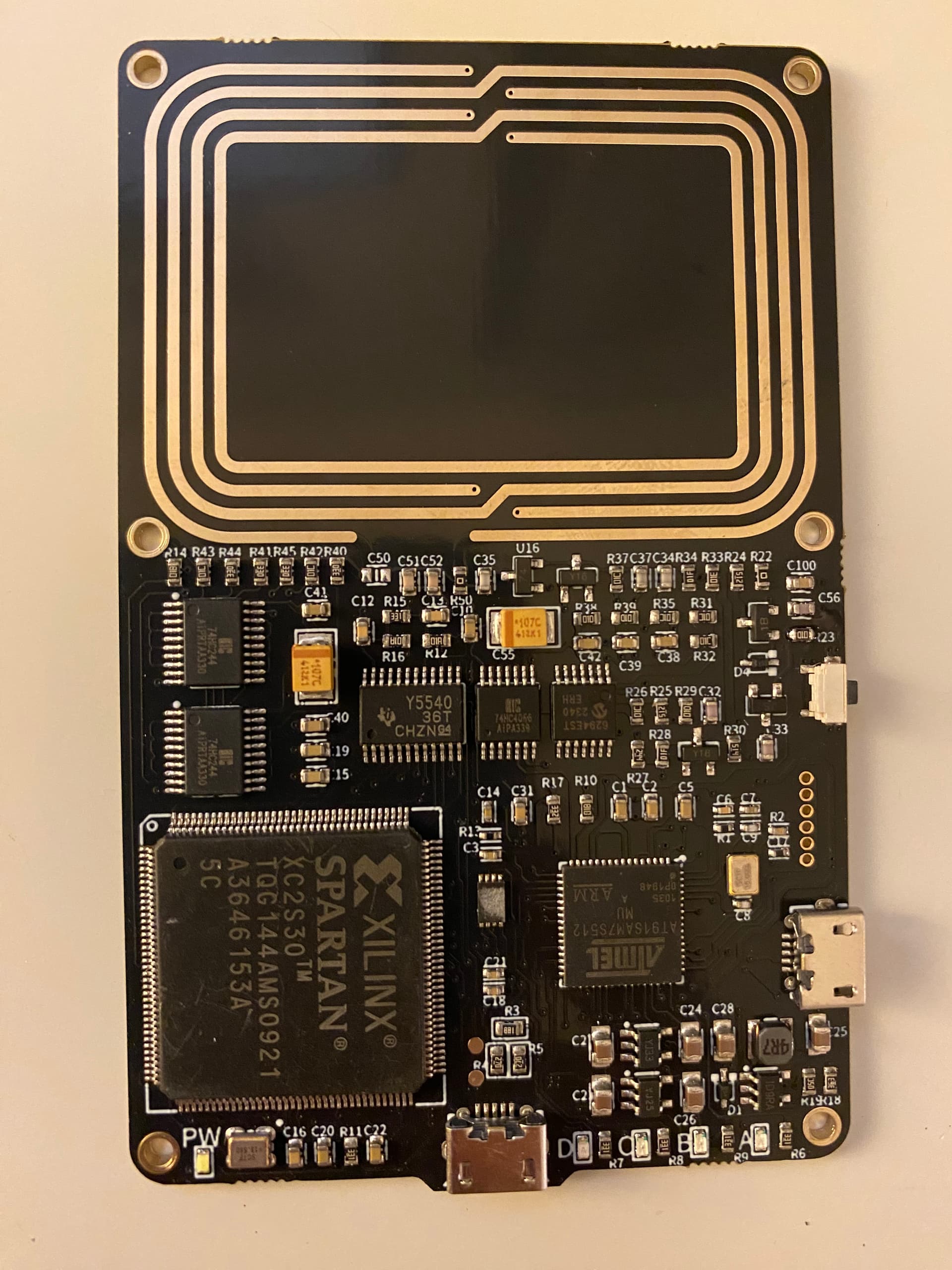

Please see the photos attached.
Hi Equipter, While I’m waiting for the new Proxmark to arrive, could you tell me how you opened the trace file to help me understand what you did? As you probably guessed, I’m using the Windows-based Proxspace and didn’t see how to open it.
ooh ok not bad, not the one i was expecting. general source recent generation piswords design proxmark, one data line’d microusb port (shame) and looks like you’ve got one that comes with SPI flash which is neat. definitely still sounds like a hw problem most likely to do with the hf antenna itself.
