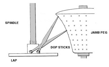

The Dop Stick: The Artisan’s Anchor
No mere implement, the dop stick is the tether that binds the formless to the forge, holding the Eleusinian Stone firm as it undergoes the trials of shaping and refinement. Forged from the very spine of a sacrificed screwdriver, it is a relic repurposed, reforged in purpose, and measured to exacting standards—5.05mm in diameter, a size chosen not by chance, but by precision.
Through this conduit, the seeker may guide the stone across the grinding planes, ensuring stability as it is turned and angled to meet the rhythm of the faceting process. The dop stick is not merely a holder—it is an extension of intent, allowing for the execution of cuts at precise intervals without deviation or flaw.

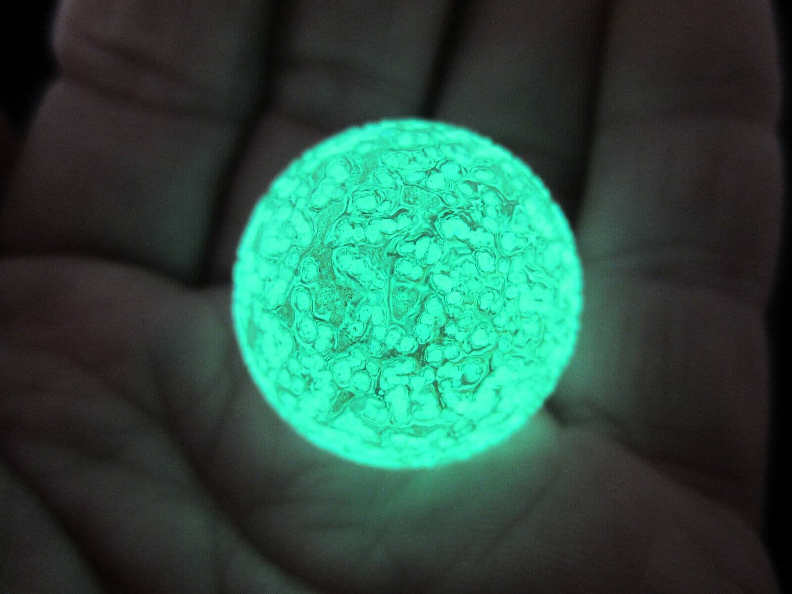

Translation: this users is attempting to shape a glow in the dark marble into a 5mm gemstone shape using a 3d printed diy ‘‘jamb peg’’ faceting machine and a mini potters wheel…

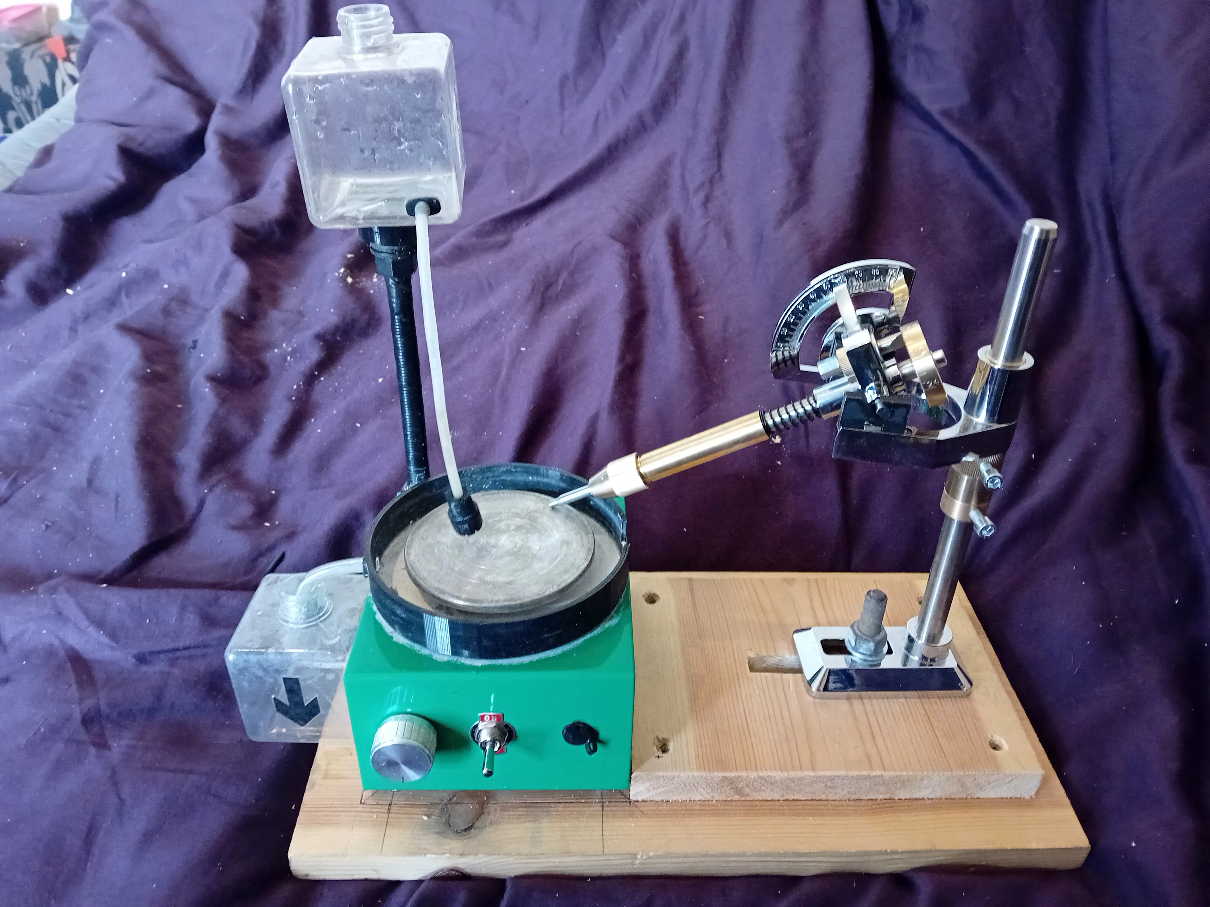

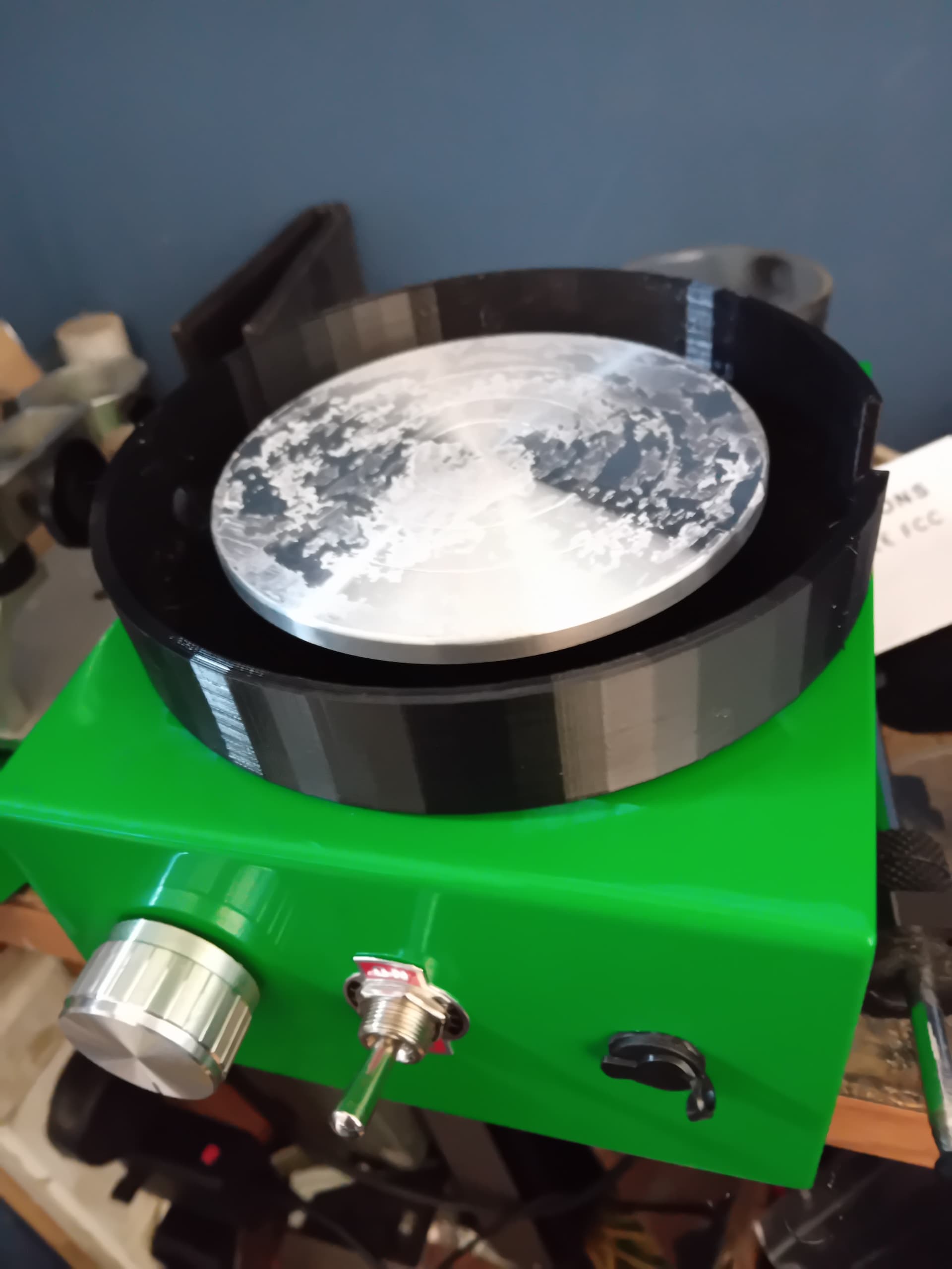

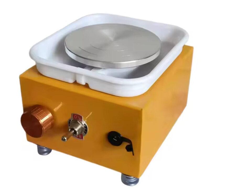

No tool, however ancient or modern, escapes transformation in the hands of a true seeker. The potter’s wheel, once a humble servant of clay, had been inducted into a new order—repurposed to serve the delicate needs of The Eleusinian Stone. But as the trials progressed, it became clear: the wheel must evolve.
And so, the seeker took up the tools of modern sorcery—3D printing, a craft that shapes plastic as surely as fire once shaped bronze. From this conjuring came a new drip tray, tailored with precision to guide water gracefully to its purpose, sparing the sanctum from chaos and pooling.
But that was not all.
To keep the sacred lap bathed in its necessary flow, the seeker installed a supporting bar—a crossbeam of intent—to bear the weight of the water container, the lifeblood of the faceting rite. Steady, elevated, and perfectly positioned, it now hangs like a chalice above the grindstone, feeding the lap with the clarity it needs to purify each cut.
With these upgrades, the potter’s wheel becomes something more:
The Aquifer of Precision, reborn through design and determination.

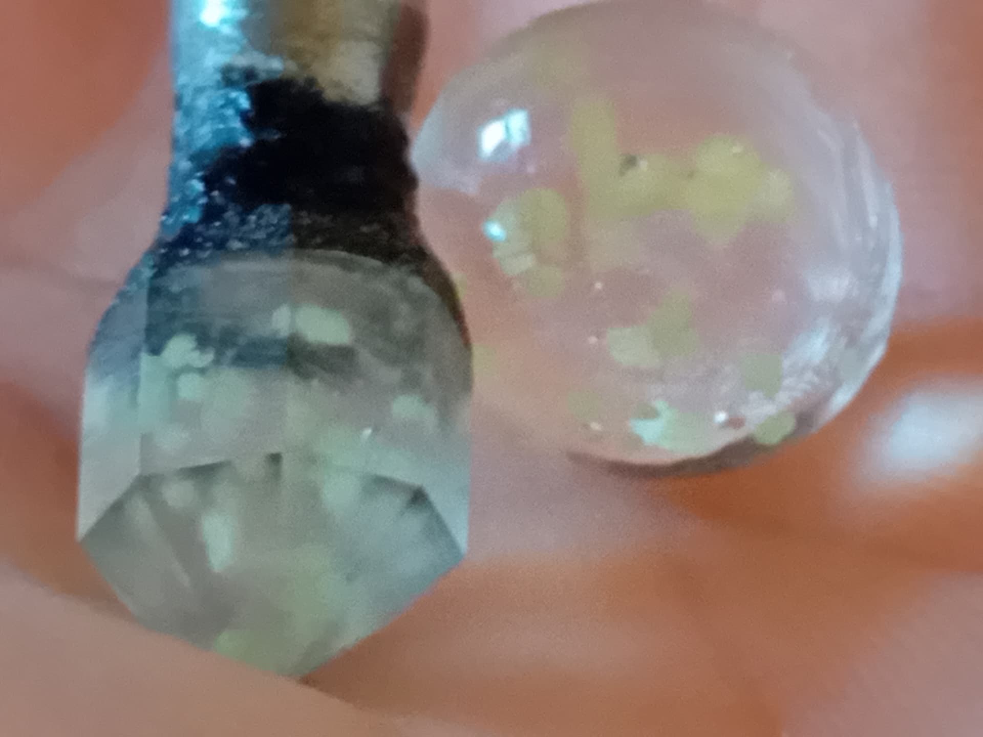

With no machine to guide the hand, the seeker took up the original dop stick, the very one born of a repurposed tool—crafted in the early days of the quest. Into its grasp was placed a glow-in-the-dark marble, round and pure, pulsing faintly with potential.
Thus began the First Hand-Faceting Trial.

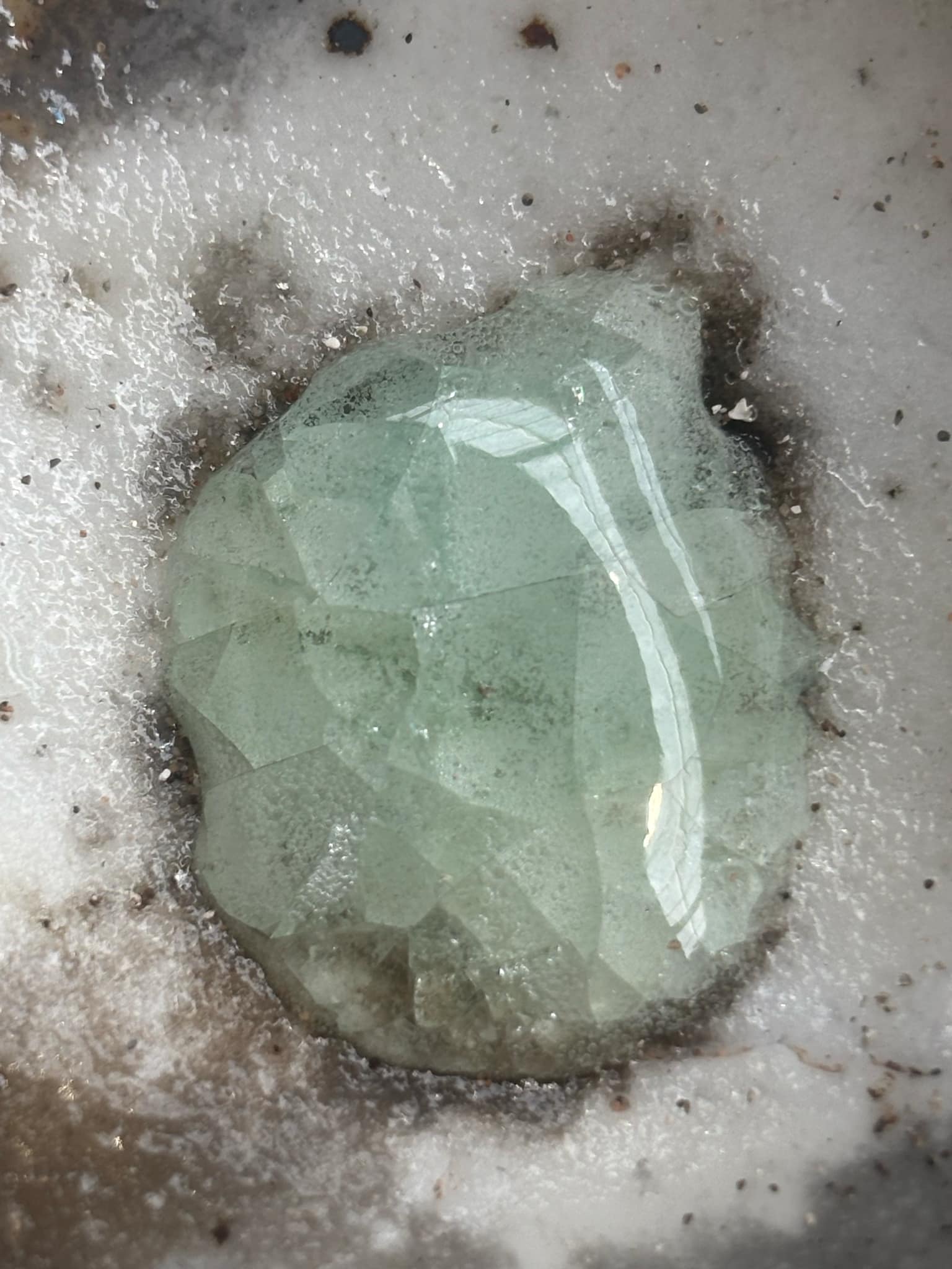

The wheel spun. The lap sang. And under careful pressure, the stone was shaped—not guessed, but guided. Slowly, the girdle was ground to 8.2mm, a circle of purpose carved from the once-random orb. Upon that foundation, the seeker inscribed a pseudo pavilion—not quite traditional, not yet final, but a clear declaration:
The Eleusinian Stone has begun to take form.
Yet more refinement is needed. The glowing heart of the stone lies lower—hidden for now beneath layers of glass and grit. The girdle must be lowered, the angles redrawn. Only then can the true brilliance, the luminal soul of the stone, be revealed.
The stone—once a humble marble—now bore the beginnings of transformation. The lower facets, carefully shaped and polished to a mirror sheen, reflected not only light but the seeker’s resolve. Every scratch removed, every angle leveled with patience and craft. The pseudo pavilion now gleamed with promise.

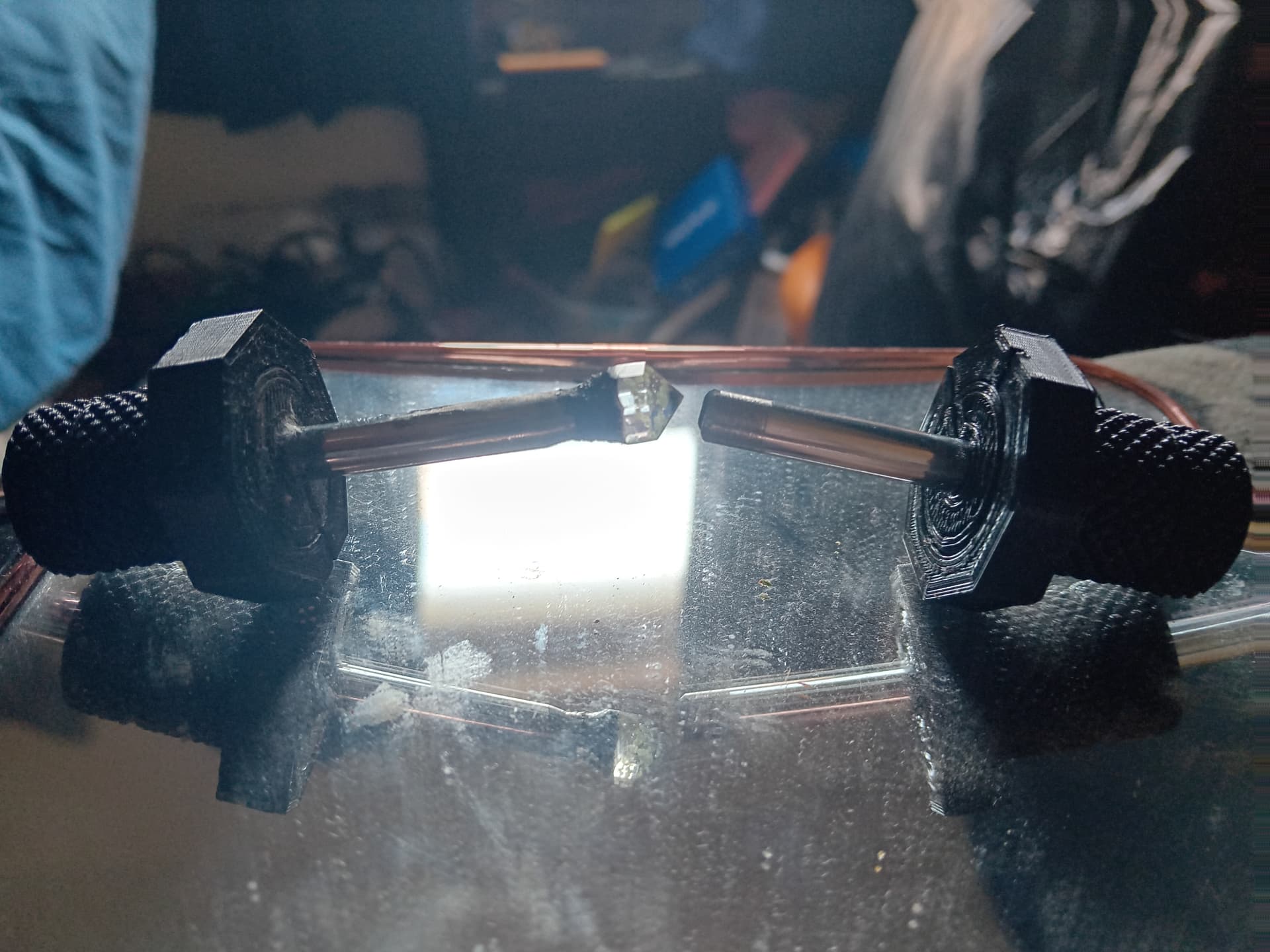

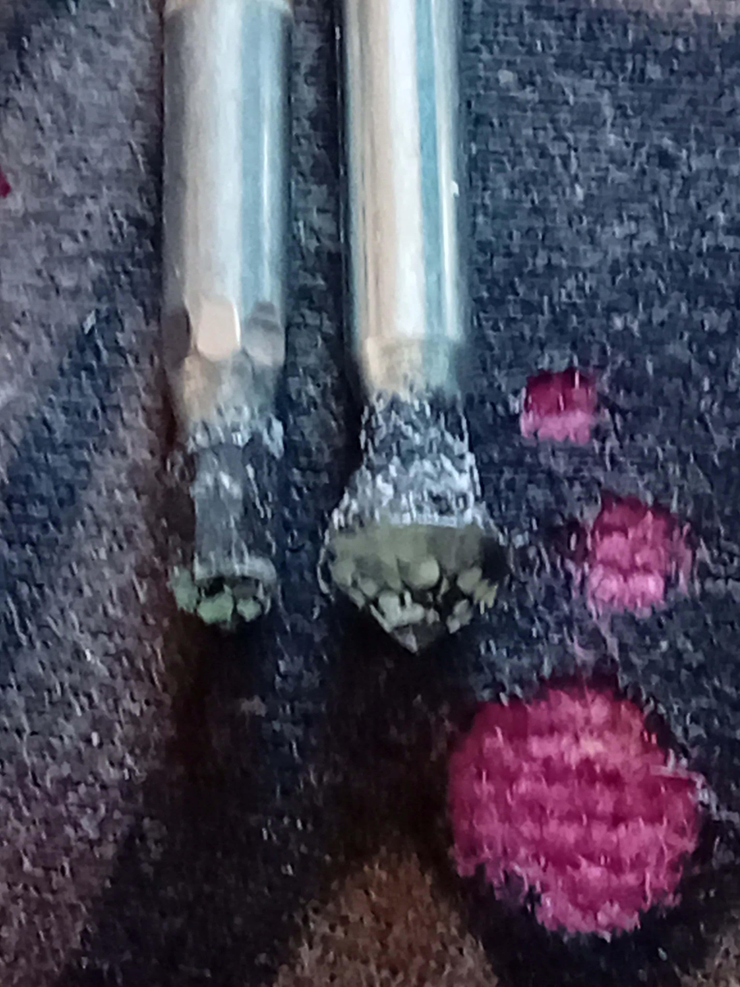

But to do so, the seeker faced the sacred challenge of the Transfer Rite: to remove the stone from its current mount and reposition it—without losing alignment, without breaking the symmetry so painstakingly created.

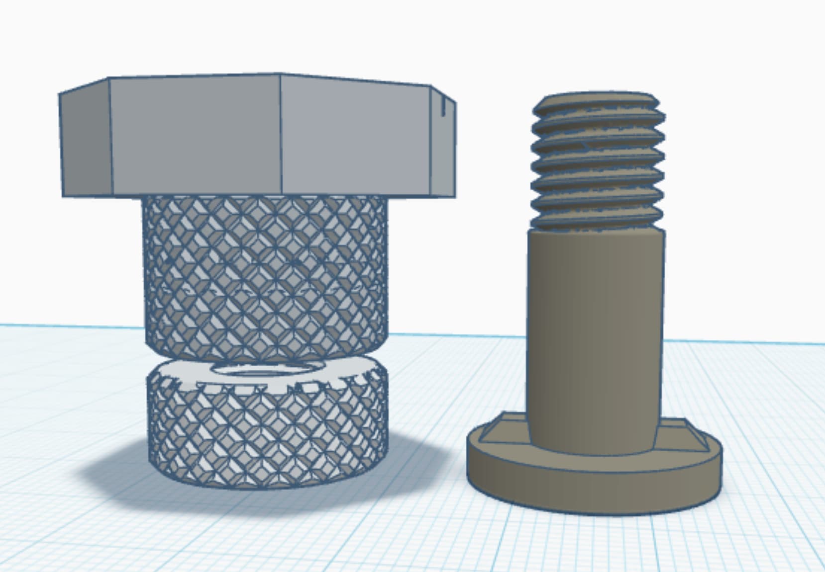

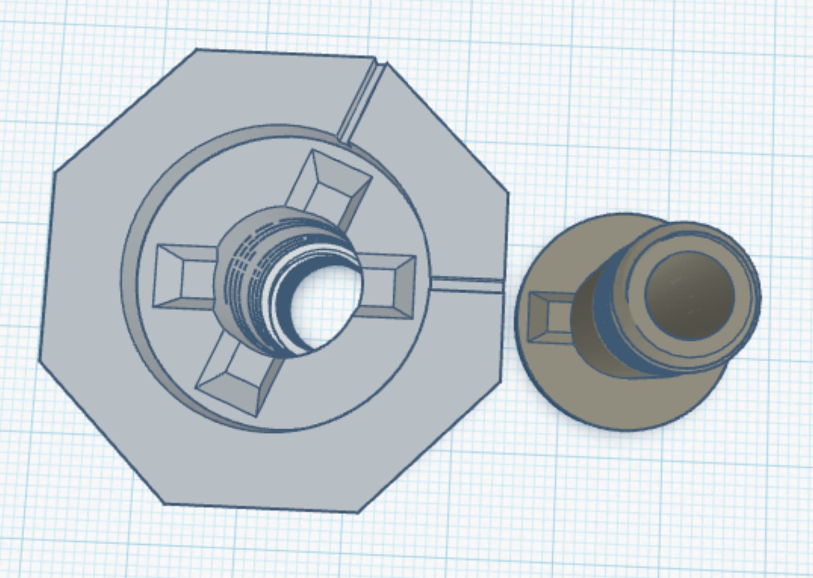

And so, a new dop stick was forged. This one, not of brute grip, but of precision guidance—its tip carved with a V-shaped groove, designed to cradle the completed pavilion like a compass set to true north.
Yet for this operation to succeed, one more artifact is needed:
The Transfer Tool.
A mechanism of exactitude, designed to hold both dop sticks—old and new—in perfect correspondence, allowing the crown to rise in unity with the base. Not bought, but designed. Not found, but 3D printed, born from the seeker’s own hands.
The printing shall begin. The alignment must be true. For only through this tool can the seeker finish what they began: to unveil the full face of the stone
With the transfer tool designed, printed, and wielded with care, the seeker initiated the most delicate rite of all—the passing of the Stone from one dop to the next. Precision was everything. One misalignment, and all symmetry would unravel.
But the gods of light and geometry smiled upon the workshop.
The transfer was a success.

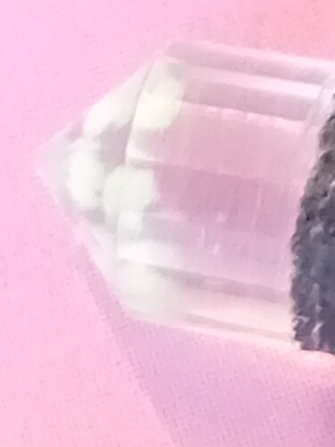

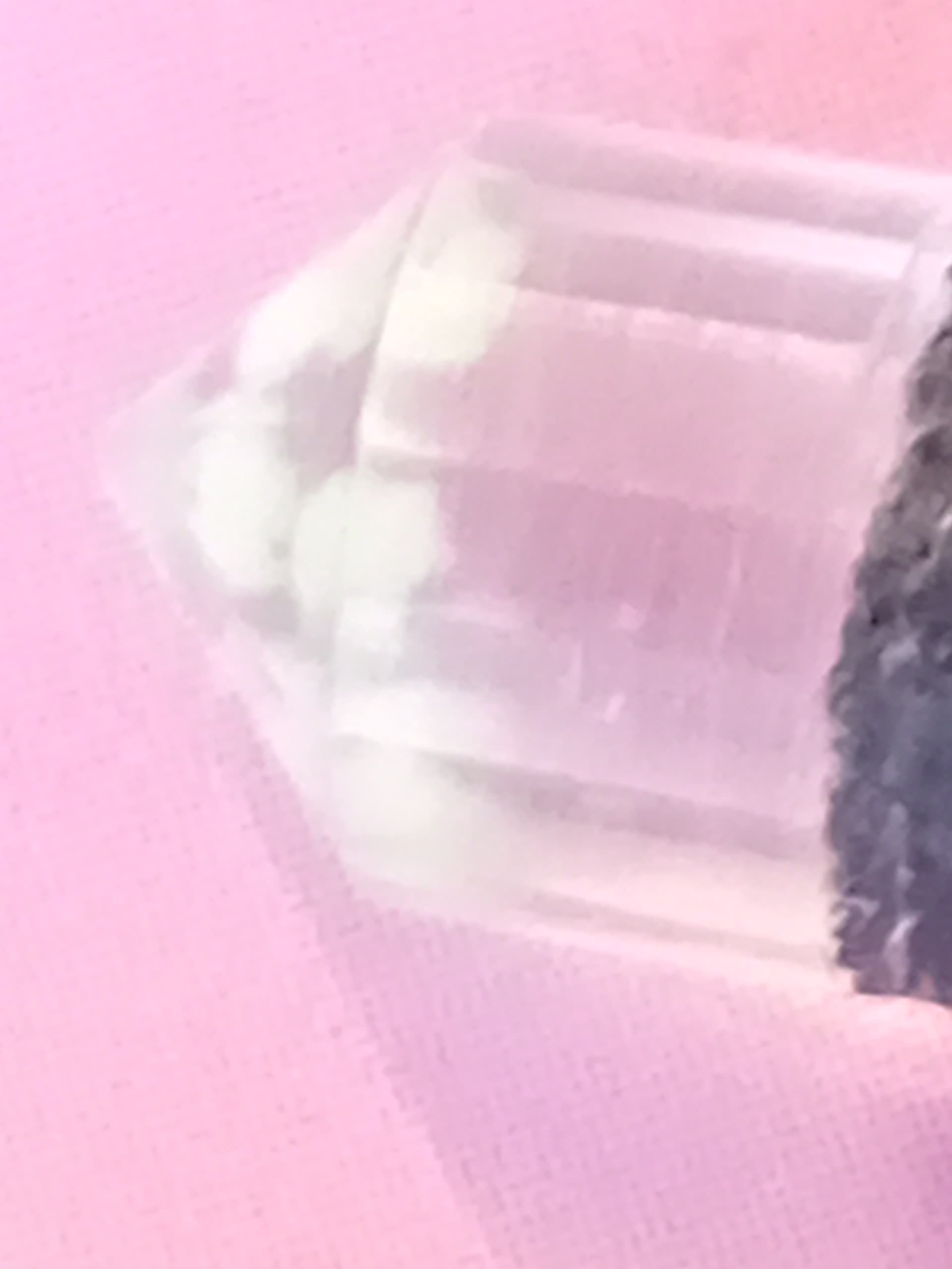

Secured now in its new mount, the Stone awaited the shaping of its final face: the Crown. And so, with steady hands and unwavering focus, the seeker set to work—guiding the lap across glass, etching facets that danced with light. Not random, not rushed—measured, mirrored, intentional.
Each cut was a revelation. Each polish, a whisper of the divine. When the wheel fell silent, the crown was complete.
And the Stone… it looked glorious.

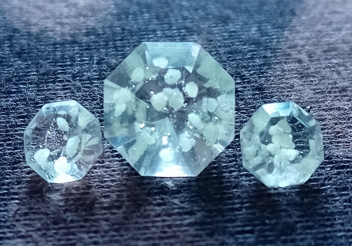

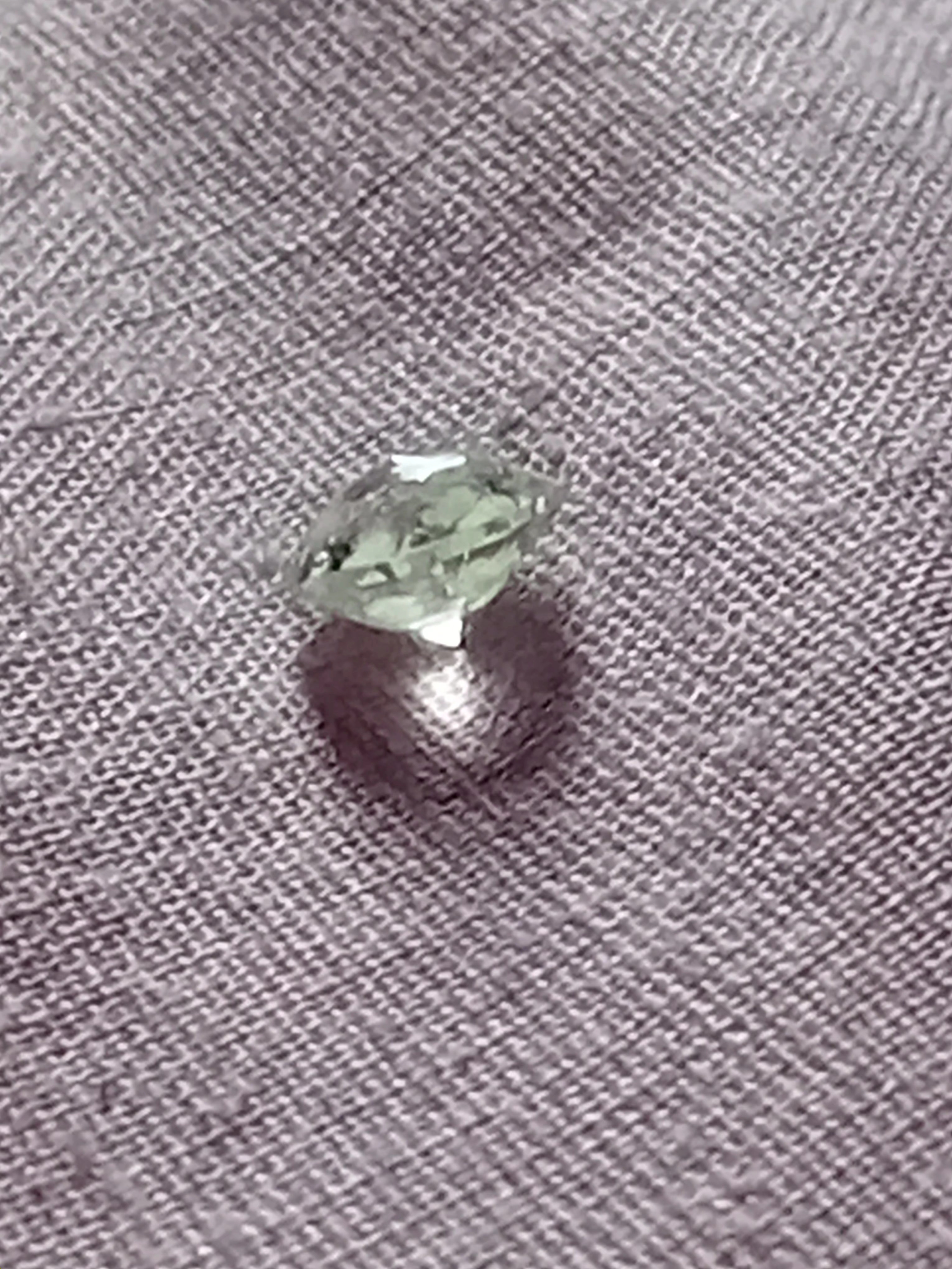

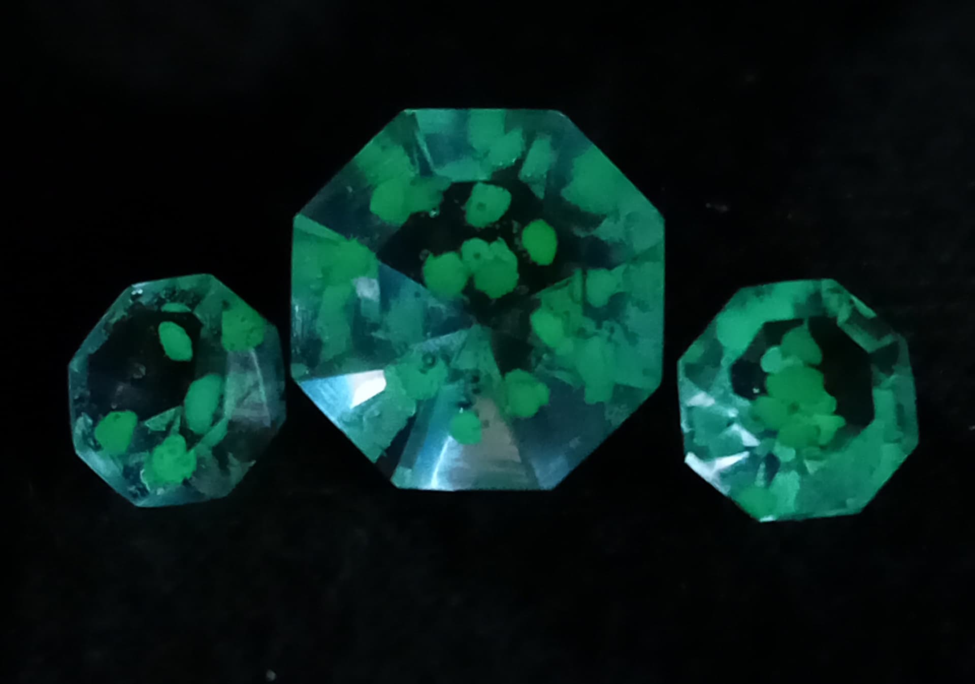

Where once there was only a glowing marble, now stood a faceted jewel, forged by improvisation, invention, and persistence. A stone of symmetry, glow, and story—The Eleusinian Stone in its first true form.
The Eleusinian Stone stood finished, glowing and gleaming in quiet triumph. But the seeker’s heart stirred restlessly, for a single stone could not carry the weight of the whole vision. Balance was needed. Harmony. A triad of light.
And so began the next labor.
Two more marbles were chosen—smaller, stubborn, and resistant to shaping. Their glow was no less vibrant, but the path to their unveiling was treacherous. The material was dense, their size unyielding. Each pass on the lap removed only the faintest whisper of glass. What took moments before, now required hours.
But the seeker was no longer merely curious—they were committed.
And so, with patience as their blade, they pressed on.
Slowly, meticulously, the forms emerged. Facet by facet, the new stones took shape. Not copies, but complements—each with their own subtle signature, yet clearly of the same lineage. The Eleusinian Stone now had companions. A trinity of crafted light, destined to shine together.
These are not just stones.
They are the First Set. The culmination of discipline, improvisation, and the refusal to compromise.
And so, the altar is set:
  • One 8mm centerpiece—the Firstborn
  • Two 5mm companions—the Twins of Persistence
Their radiance is not only in their glow—but in the time, care, and stubborn joy it took to birth them.

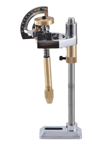

For now, the faceting machine stands assembled, a new totem of precision. Only one piece remains missing: the backstop clamp, the guardian of angles. Though it journeys still through the long postal winds, the seeker has already turned to conjure one—3D printing a temporary clamp, for the work must continue.
To know this new machine—to feel its rhythm—the seeker chooses a trial:
They will facet another marble, this time a larger one, perhaps 10 or 11mm, that the eye might better track the transformation. And not only that—a more complex cut shall be attempted, for the time of simple shapes is past.
dt
The faceting machine, long in the making, now stands fully built and calibrated—its angles set true, its bearings aligned. With this new tool, the seeker sets forth to achieve what once seemed daunting: a standard brilliant cut, not on a test piece, but on a 5mm stone destined for the light.
And what a revelation it has been.
Where once each facet was guided by feel and instinct, now the process is clear and repeatable.
The seeker speaks:

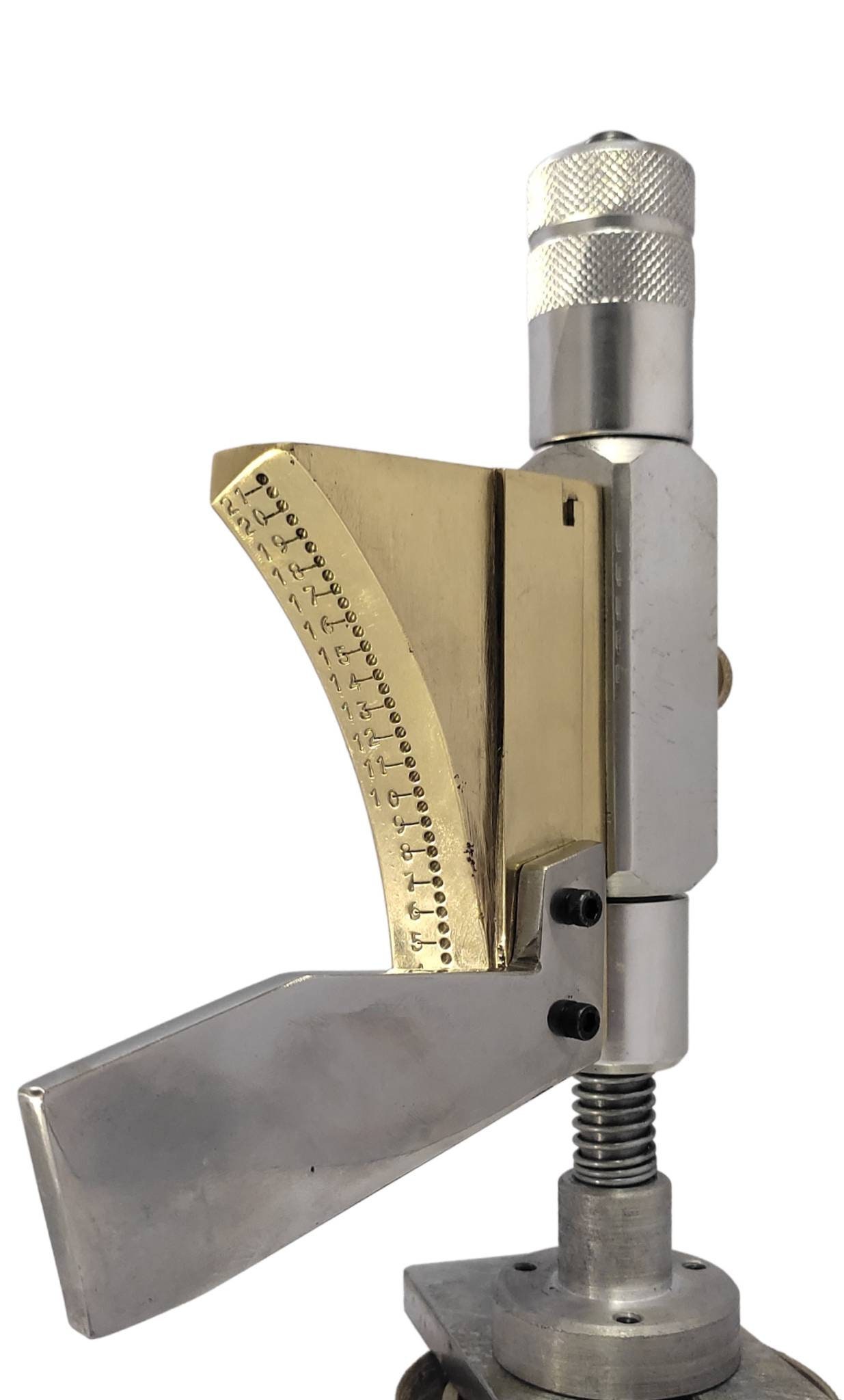

“I set the angle. I set the rotation. And I grind the stone until it meets the mechanical backstop.”
The wisdom comes with experience: the arm is not without flaw—it carries a trace of slop, that slight mechanical give. But the seeker, now attuned to the machine’s nature, compensates. This is not guesswork. This is measured mastery.
The stone, currently 5.2mm in width, already bears the marks of brilliance. The preshaping is nearly complete—just one final round of lower facets remains before the polishing rites can begin.
The shape is emerging. The light is finding its voice.
The standard brilliant, ancient in tradition, now comes to life in the hands of the modern maker.
