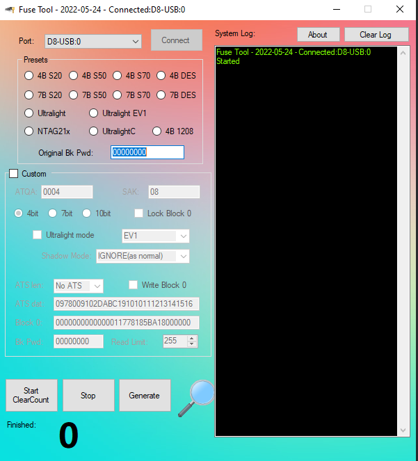

The flexUG4 can clone NTAG21x tags iirc.
indeed it can!
(read presets)
