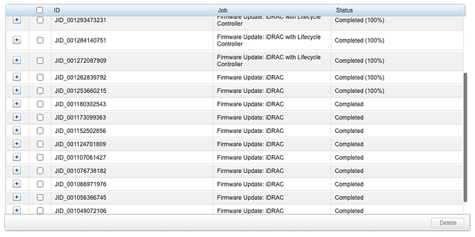

idrac was out of date by like 4 years. It was so out of date i couldnt access from the web interface because its encryption was too poor. i had to use an old Windows 7 computer to log into it.
So i started doing incremental updates version by version to get it current. At version 2.20.20.20 fans all got pegged at 100%. Bios settings, idrac settings changing things around i could only ever get them as low as 50% ALL THE TIME.
