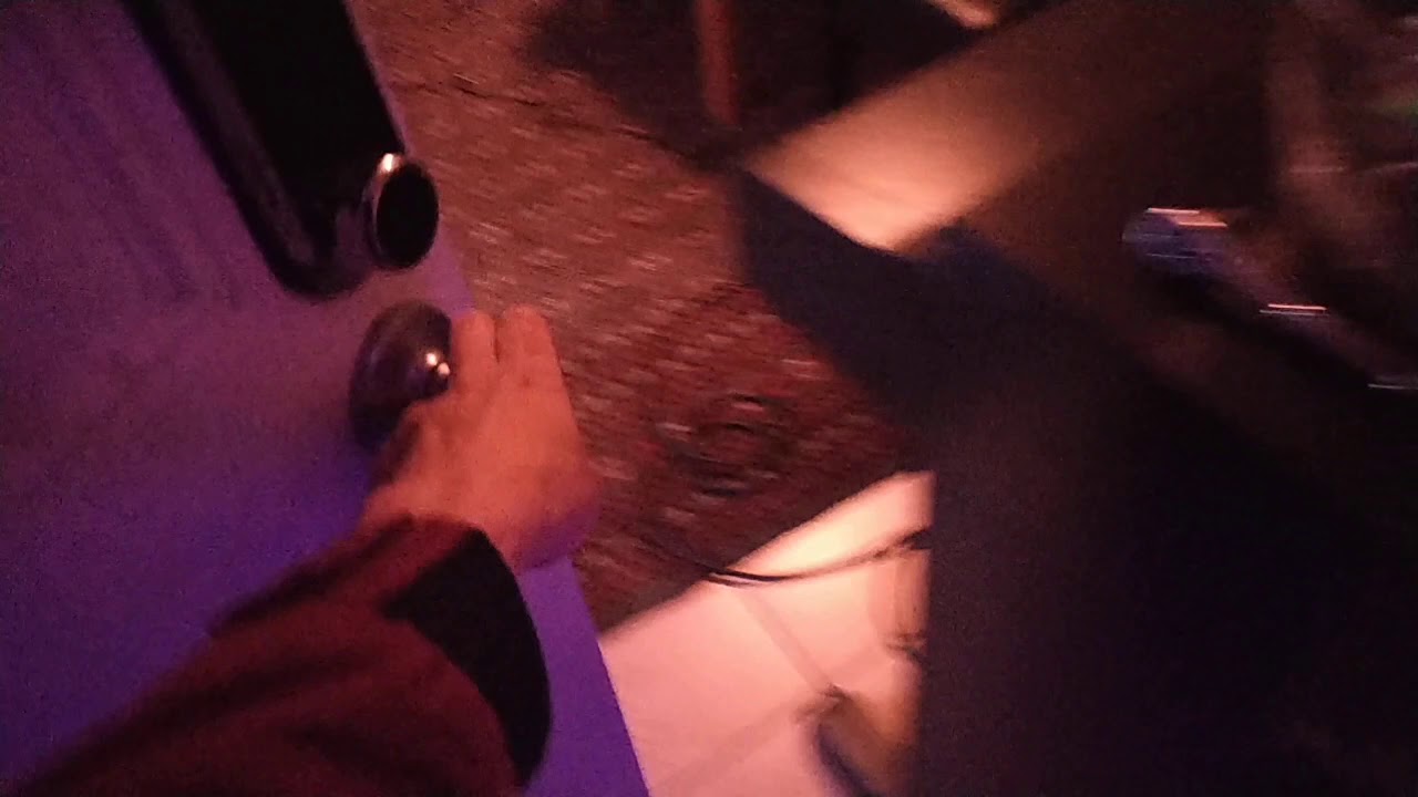

Ladies, fellas, and people who don’t give a fuck, I’m happy to announce that doing this firmware rollback has allowed me to open my deadbolt with my xSIID chip.
Also, funny story, I ended up not soldering anything… the end of the Molex connector broke, so when I realized the exposed wire is actually already in a clip shape, I simply clipped that wire to the connector on the PICkit. That was the most simple workaround and I’m glad I accidentally broke it.
if anyone wants to update the Chip Compatibility Matrix, I offer my anecdotal experience as evidence it works. :grin:
