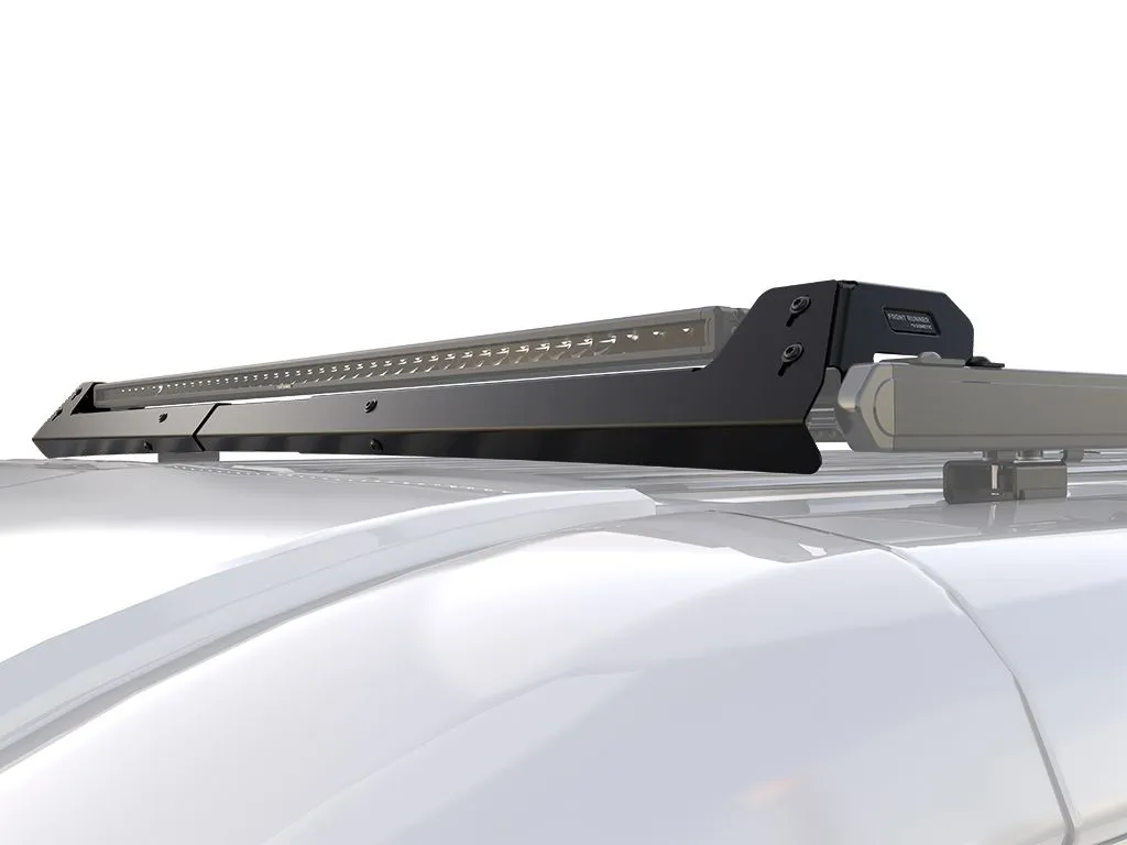

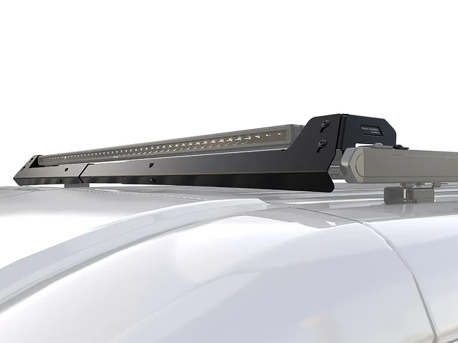

They make wind guards for light bars:
Perhaps something like that could be adapted

There are aero blocking kits for panels.

And I’ll look more into these aero blocking wind bars. I guess the principle is to break the wind before it enters the slit between the panels and the roof?
