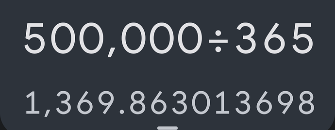

I believe the p71 has a 500,000 write cycle count (called endurance) per cell… that includes a full cycle of erase and program… so it’s quite resilient. If you wrote to those cells once a day, every day of the year, you’d be able to comfortably fit in well over 1300 years of updates.
Even writing 10 times a day, every day of the year, you’d still get well over 100 years of safe updates. I think it’ll be fine ![]()
