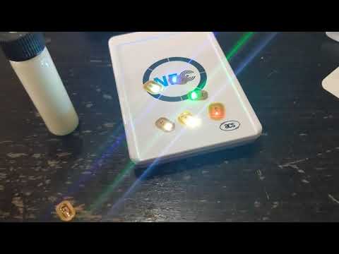

yeah … oddly the white does not charge the glow powder for shit. this has more to do with how LEDs emit light in distinct wavelengths and the combination emitted to create a “white” LED does not have enough energy to charge the powder.
What’s funny is that, if I were to go with white I’d rather have it on its own.
But if I choose glow resin; which do you think would charge it better? Light blue or deep blue?
ok i just did a test with all the colors i have and dark blue, purple (which I’m out of), and white (surprise!) do charge the glow resin.
The thing with white just illustrates how difficult it can be getting stuff from China where there is no guarantee the product will remain consistent from each individual unit to the next… I tested some white NFC nails from vendor A and they did not charge the glow resin at all… but then I just tested another basically identical looking white NFC nail from vendor B and it did work… so then to compare I tried another white LED nail from vendor A and it also worked… so like… they obviously mix and matched their white LEDs making these things… so I will have to test each LED before using it with glow powder. ugh.
Looks like dark blue with glow resin will be ideal for me

Just a thought, wonder if you could get the led in a UV flavor, that would charge the glow powder like nobodies business
UV damages skin cells (except far UV-C)
Not sure if it would have the power,
I’m talking about the like “security” flashlights used to check ids
Essentially a black light led, idk if that’s actually the “bad” uv
Possible.yes but voltage requirements of UV LEDs is very high… 6v-7v DC typically… not likely to pull that from an NFC antenna coil with sufficient current to do anything, and definitely not from an energy harvesting IC like the ntag i2c
