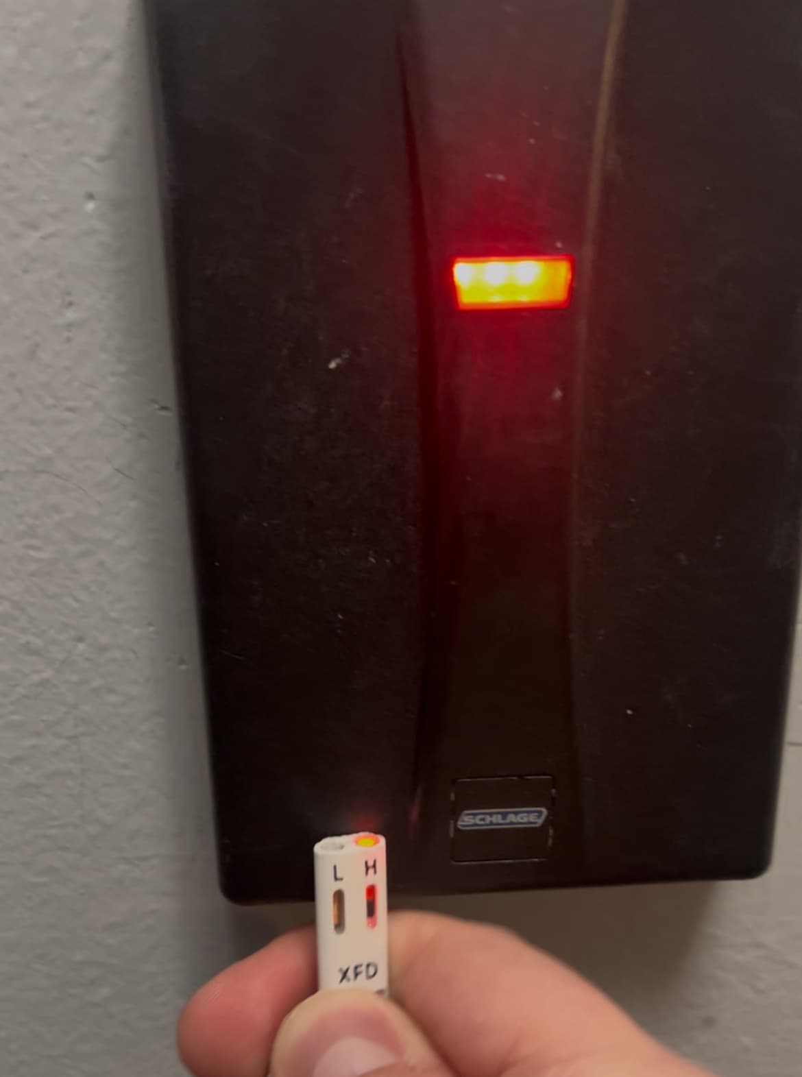

Today i put up the field detector up the Schlage brand reader and to my surprise, only the HF side lit up. So i’m totally confused right now.

while you’re there can you grab a pic of the reader? i’ll confer with the dark forces and see what i can find re optimising placement for scanning & any behavioural tricks to get it to pick up

Sorry for the bad quality, took a screenshot from a video. Looks like it might be [this reader?]
(https://picclick.com/SCHLAGE-Single-Gang-Wall-Multi-Technology-Smart-Card-Credentials-263993826178.html)
guessing the different positionings weren’t successful?
Not successful with LF. HF worked like a charm around the edges.
Might be this one instead? I’m guessing in this case, the RFID side of the NExT won’t work with this reader.
ok word, definitely a multi tech reader its a shared model between a few companies, but looks like it’s not enough to pick up LF on an xseries sized antenna unfortunately.
The only recourse for using your implant with this reader would be to persuade the sysadmin to add your HF 14a UID to the user group, which would come with its challenges but is not impossible.
