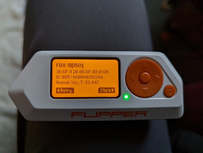

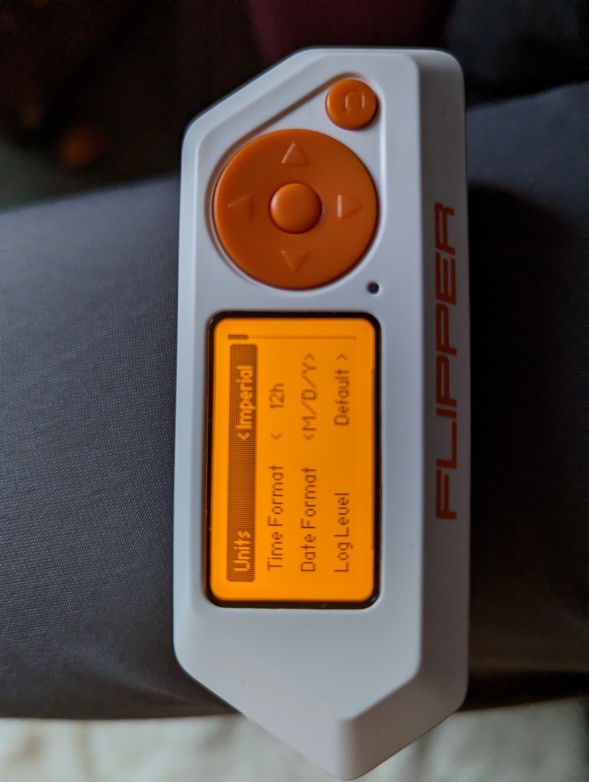

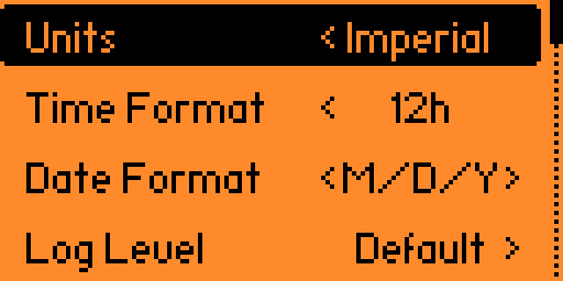

Flipper still reporting xBT output in Celsius after changing Units to Imperial, just FYI. I’ve logged this with the Flipper team to see if they have any insight.

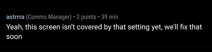

Update from /u/astrrra on Reddit:

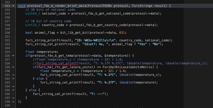

Open protocol_fdx_b.c in a terminal editor or a gui editor like bbedit or VisualStudio
after line 6 add a new line and add this include doc
#include <furi_hal_rtc.h>
then scroll to line 327. you can delete line 327 and 328 or comment them out.
        float temperature_c = (temperature - 32) / 1.8;
        furi_string_cat_printf(result, "T: %.1fF %.2fC", (double)temperature, (double)temperature_c);
and in their place at line 327 add the following 6 lines
        if(furi_hal_rtc_get_locale_units() == FuriHalRtcLocaleUnitsMetric) {
            furi_string_cat_printf(result, "T: %.2fC", (double)temperature_c);
        } else {
            furi_string_cat_printf(result, "T: %.2fF", (double)temperature);
for reference
This is now commit #2941 and awaiting merge into the official Flipper firmware.
So edit if you want the new new, but it looks like it should go out in the next release. i compiled and flashed it and it works great.
this write up is still relevant
