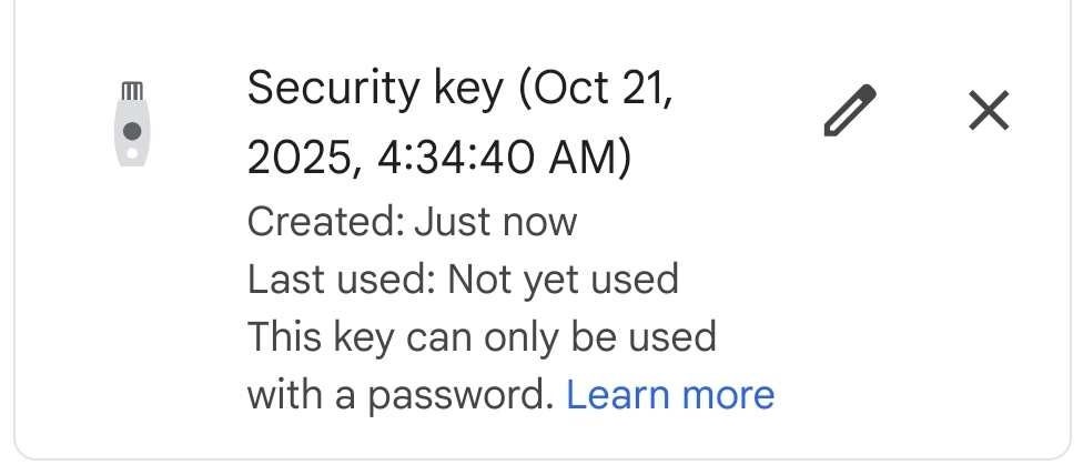

When I add my vivokey using the latest applet
to my Google account it doesn’t recognize it as a normal fido2 device. From what I understand it is seeing it as a u2f device instead as seen with the “This key can only be used with a password.” Meaning it doesn’t work for passwordless logging only as a 2fa method.
Is this a known issue with Google? I’m using Firefox and I have tried via android and windows reads.

  5. Going back to my android phone, logging out and then trying to use the new passkey. It doesn’t prompt for pin, then google says it is U2F even though it is working as FIDO2 on my windows 11.
So the interesting thing here is that the same implant with the same UUID can be used as both U2F and FIDO2. This is concerning on google’s end because it means you can still use hardware passkeys without google getting access to your resident keys on the device. They just silently fail saying that the device can only be used for MFA instead of failing and saying there was an error.

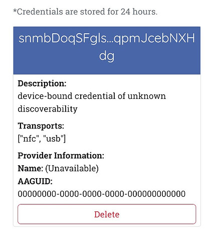

I believe you’re right. The odd thing is that I’m seeing some weird behavior from my implant. At least on webauthin.io it shows the implant with a blank ID
The first (NFC only) is my phone’s native NFC scanning, and the second (NFC and USB) is using the vivokey NFC bridge as the scanner. The bridge at least asks for the pin but still says unknown. Is this normal?
Edit: so users can find via search the screenshots are showing this information. The following being from windows 11 using an ACR122U instead of android but showing the different results:
Description:
device-bound passkey
  1. Transports:
    [“nfc”]
  2. Provider Information:
    AAGUID: 00000000-0000-0000-0000-000000000000

Here’s a chart with the results of each test.
# Settings Pin Verification Requested OS Browser Via Result Description Transports AAGUID Notes / Errors
1 Default Both Windows 11 Firefox ACR122U device-bound passkey [“nfc”] blank
2 Direct Both Windows 11 Firefox ACR122U device-bound passkey [“nfc”] correct UID returned
3 Default No Android 15 Chrome OS device-bound non-discoverable credential [“nfc”] blank
4 Direct No Android 15 Chrome OS device-bound non-discoverable credential [“nfc”] blank
5 User Verification Required N/A Android 15 Chrome OS OS doesn’t offer NFC option when UV is required on Chrome
6 Direct On register Android 15 Chrome Bridge Flow through bridge ended “Success”; site error – “Unknown error talking to Credential Manager”
7 Default On register Android 15 Chrome Bridge Flow through bridge ended “Success”; site error – “Unknown error talking to Credential Manager”
8 Default No Android 15 Firefox OS device-bound non-discoverable credential [“nfc”] blank
9 Direct No Android 15 Firefox OS device-bound non-discoverable credential [“nfc”] blank
10 User Verification Required No Android 15 Firefox OS No PIN prompt even when UV required → “User verification required but not verified”
11 Default On register only Android 15 Firefox Bridge device-bound credential of unknown discoverability [“nfc”,“usb”] blank
12 Direct + User Verification Required On register only Android 15 Firefox Bridge device-bound credential of unknown discoverability [“nfc”,“usb”] blank
