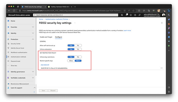

You can change attestation requirements in Entra ID settings, and I believe you can even add specific AAGUID exemptions.
To leave “Enforce attestation” enabled, you should be able to add our AAGUID to the Allow list. This screen shot shows a block list, but if you slide the slider over to Allow it should present a whitelist you can add the VivoKey AAGUID to.
The AAGUID to allow is c84689382e9f4e9382cae59cd24d67d8 or c8468938-2e9f-4e93-82ca-e59cd24d67d8 depending on your formatting needs.
