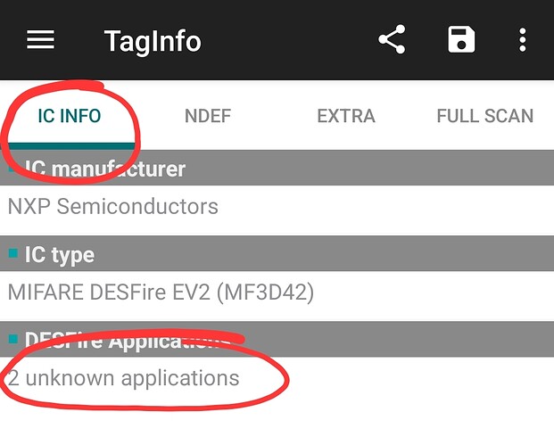

To test this, Scan your Work card with TagInfo
You would be looking for something like this… Infact, Hoping you don’t have this
