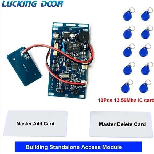

I came across this board:
It looks like it includes a PN532 v3 reader so the range won’t be ideal. It still looks better than most of the chinise counterparts IMO.

3. Would the HF side of the NExT work with this (obv the 13.56 one)? I couldn’t see on the AliExpress website what specs it had.
4 (I’m a liar!!) So if I got (and I have) both the 125 and 13.56 of this listing they’d both work with the NExT? I thought I’d asked that somewhere but can’t find it if I did.

@Eriequiet answered you above, I just happen to remember why your asking, Your 2FA door lock for your Bus conversion correct?
I have that same HF reader, and its “made for” Mifare Classic 1k BUT I’m pretty sure I’ve used it with DESFire EV2 and NTAG216 (NExT), you just need to use the “ADD” card to enroll it and you’re up and running.
I’ll dig out my reader tomorrow and confirm it for you (Worst case, it’ll be the day after)
If it works, then yes, the NExT will be the best key for your 2FA locking system

Any chance you might have been able to check that 13.56 reader with the NExT?
:grimacing: :grimacing: :grimacing: :grin:
Just following up!
Of course, I haven’t forgotten, but I eneded up away from home for a few days
Is this the reader I bought?
Yes, I think you do, if not, you have a very similar one
Yes, I got 3 like yours from ali express

I can confirm with mine when I get home… I have a demo kit with bread board in my rfid bin
I’m 95% sure it sure be fine with the next… I would have tested it with any 14443a implants I had… I just don’t have written record of doing it

Sorry its taken so long, but blah blah blah excuses etc.
I wanted to give you more info. But for now I can tell you it will work with a NExT
