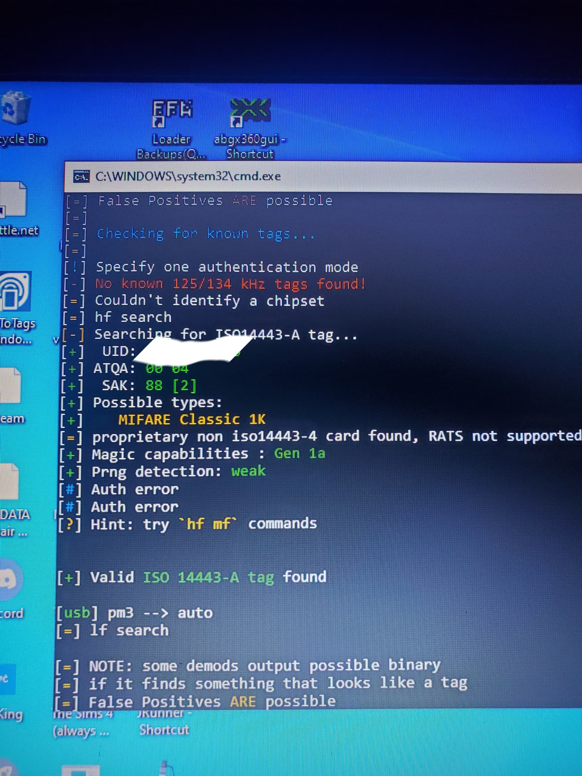

Alright, so after a week of it working Ive discovered 2 things. 1, prox got here today and yall were not kidding about the learning curve, and there is a difference between the 2 creds. I cant figure out how to view a dump, i just have bins and jsons laying here. But the sak is different, along with prng whatever that means
My hand is 88, badge is 08

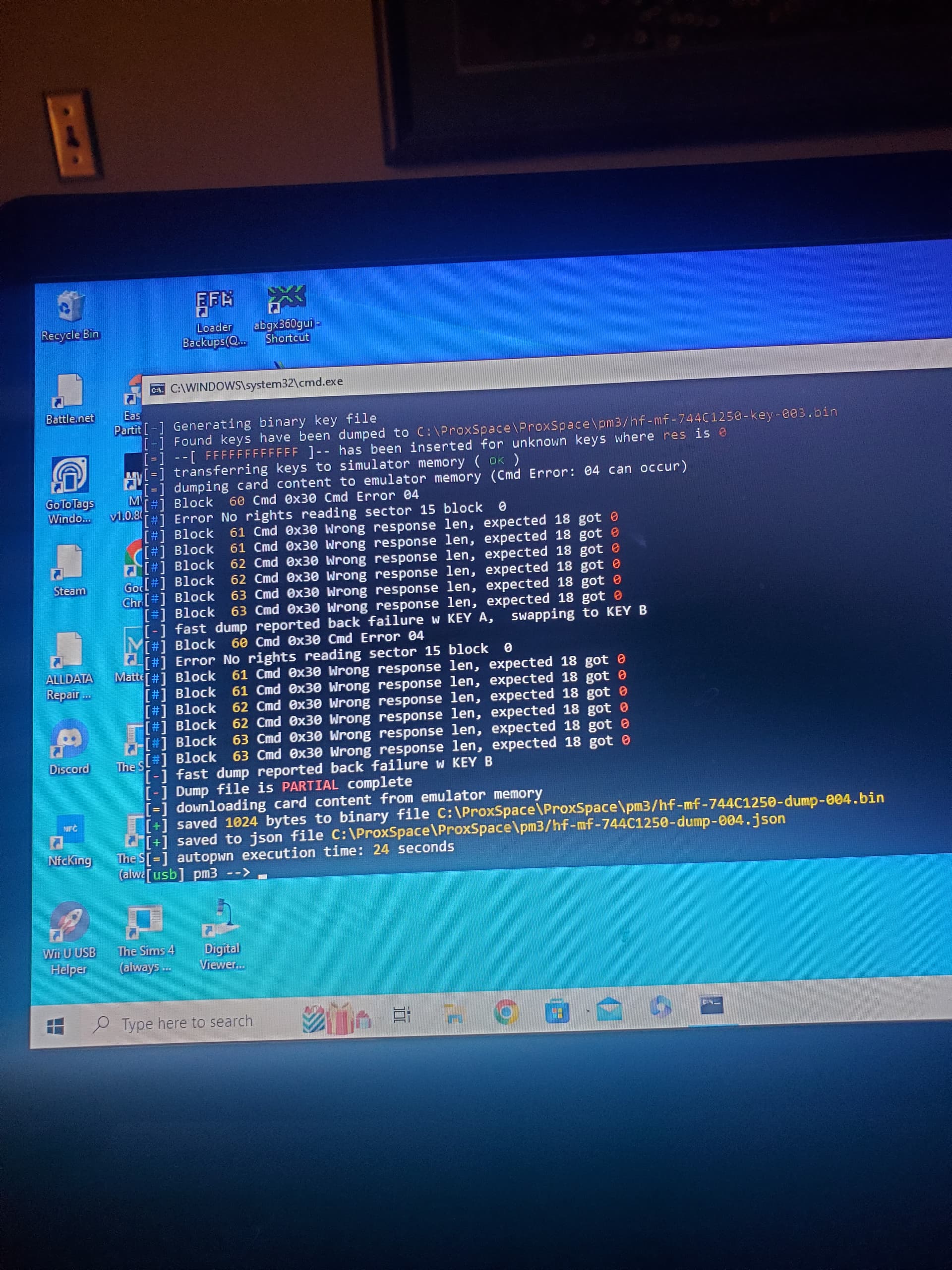

And 2. The one in my hand seems to not need to be charged, after that first time it hasnt given me any issues, however i cant get into the er, not sure whats missing there. There seems to be 2 “paths” badges here can take, one half of the hospital or the other. Patient access and vendor badges can get anywhere, er stays on that half and managment and nurse floor get the other half. I seem to have management access, but for some reason not the other half
Edit: tried to dump chip, gives this error
