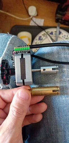

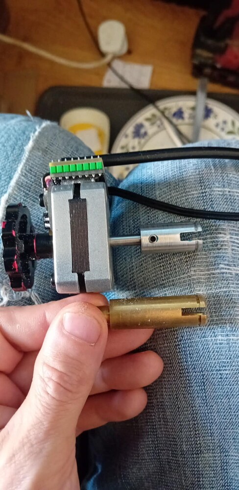

Here is @W-rabbit using the lock and it looks easy.
unlocking my METechs MID300 with my NExT
If I recall correctly, the pineapple sticker covers a mod to the lock face.
also seach the forum for Mid300 to find a few more results if you are interested
I could make the talos lf very easily if that would help. Designed to fit a eurocylender
