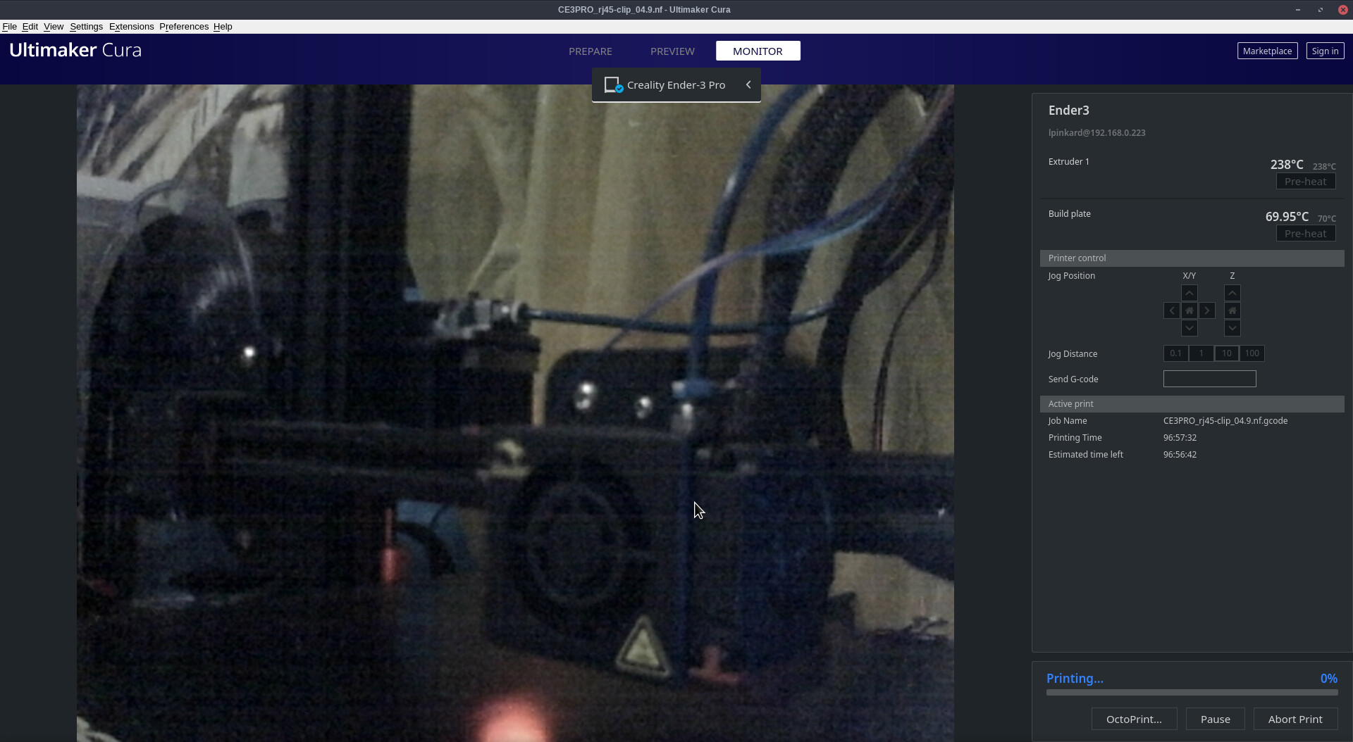

I decided to go ahead and re-do my OctoPrint setup, now that I have a spare Raspberry Pi 4 lying around (this Pi 4 has a lot of GPU issues, but otherwise it works, so it’s good for this).
One of the things I’d make sure you set up is Cura integration, if you use cura. It’s super convenient.
It adds a print button right in cura after slicing, that automatically starts the printer. It also adds the camera view, and full printer controls under the monitor tab of cura:
Ignore my terrible camera quality, I got this webcam for like $2 on sale at a grocery store.
