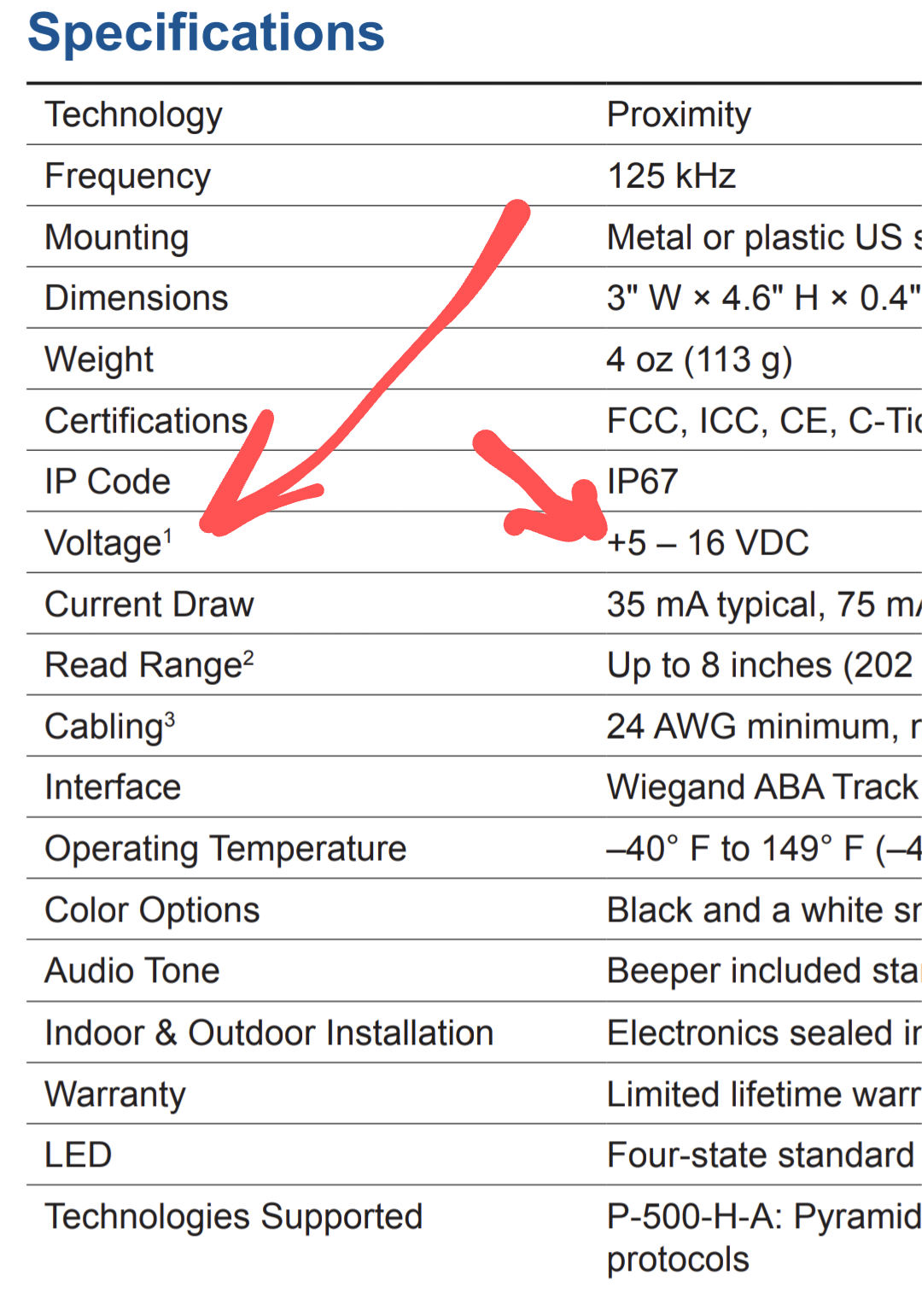

One of the readers is Mircom TX3-P500-HA. It functions well with other cards at decent range (3-5cm) while being powered by 5v.
Look at the spec sheet.
5 volts is the minimum operating voltage. Give them 12 volts and enjoy the increased performance!
