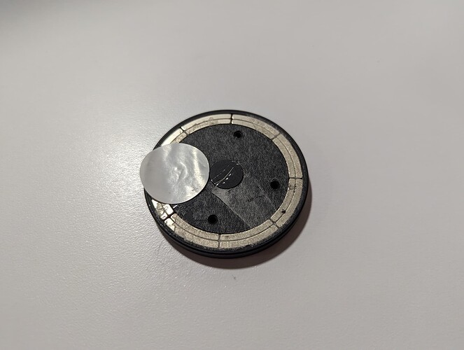

I wanted to put an NFC sticker on a car dock so when I stick my phone there it knows it’s docked and can switch to the driving view. I got the dock and put the sticker on and the phone doesn’t read the tag. I peeled it off and it reads fine, put it back on and nothing. I started wondering if it was because of the magnets but I was able to read the tag in proximity to other magnets so I thought I’d post here looking for a better idea of what’s going on.

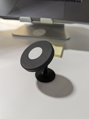

Here’s the dock with the tag on it.

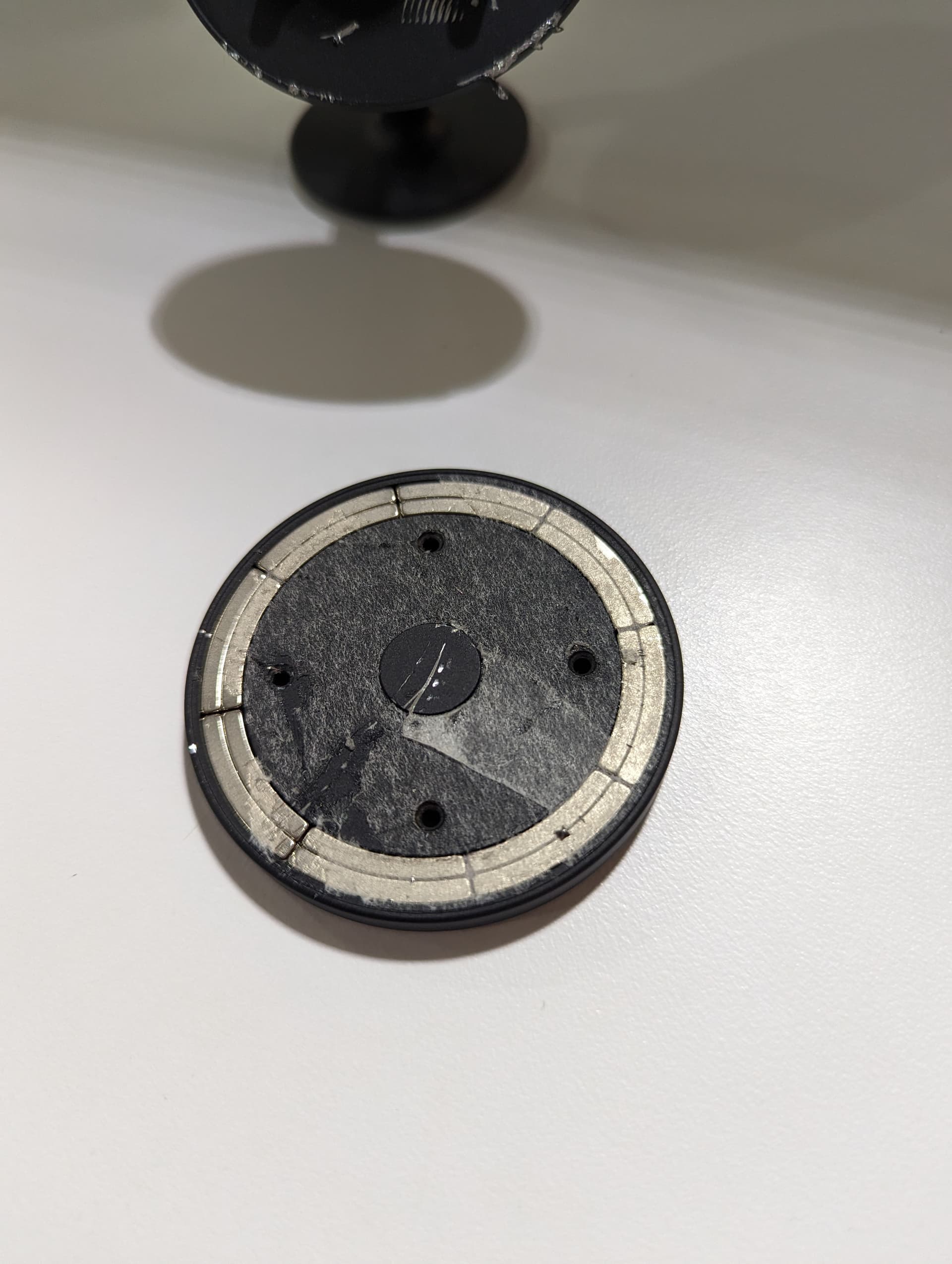

Here’s what the magnets look like when I tore the dock apart.
The magnets are strong but not crazy strong. I can’t stick my xG3 v1 to it without any discomfort. I wondered if it had something to do with the alternating poles? I don’t know. Any advice or ideas of what to test would be appreciated.
