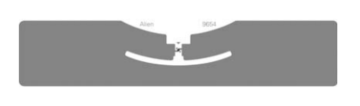

Hi,
Can this RFID be cloned? If so, with what tools? Alien G RFID White Wet Inlay (ALN-9654, Higgs-3)

From the little research I did, it looks like the tag operates using UHF. It might be possible to clone (not entirely sure tho; I’ve never messed with UHF stuff), but you’d need a UHF reader/writer. The Proxmark3 won’t cut it for this one.
In terms of implants: someone correct me if I’m wrong, but I don’t believe UHF implants are really feasible. The range would be very disappointing once implanted.

No it’s just that UHF is an active RFID thing, so you’d need a battery and no one wants to implant currently available batteries.
There are both passive and active UHF systems. Passive tags are like what stores use on packaging (or the tag linked above).
It’s 100% possible to implant a passive tag, but Amal and Satur9 have stated in the past that skin messes with it a lot more than HF or LF tags.

Also many UHF tags are Global EPC style tags which generally speaking only carry an EPC code (sorta like an RF version of a UPC product code)… and it is common that you can re-write the EPC ID of these tags fairly easily which, on UHF tags, is called “recycling”. The question becomes - why would someone want to clone one of these? The obvious inference is that someone is using the EPC code as some sort of access or security measure? That would be pretty dumb, but I’ve seem a lot of pretty dumb security implementations before. Though, read the bit below about the 4 memory banks… the EPC code is recyclable but the TID memory is read only… perhaps someone figured the TID would be just as “secure” as most passive UID based systems?

So what device do I need that can do the UHF “recycling”?. Thanks
well i think if that’s the case then my hunch would be that it’s using the TDI memory bank of the EPC tag… at least i would hope so… and you can’t change that… but if you wanted to play around with it, pretty much any UHF reader should have the capacity to update / change the EPC code of just about any tag… the only thing is all these UHF readers typically require middleware or some form of commercial software to do this … that’s because they are used in factories and warehouses typically… and these are well outside the scope of what we normally deal with here.
