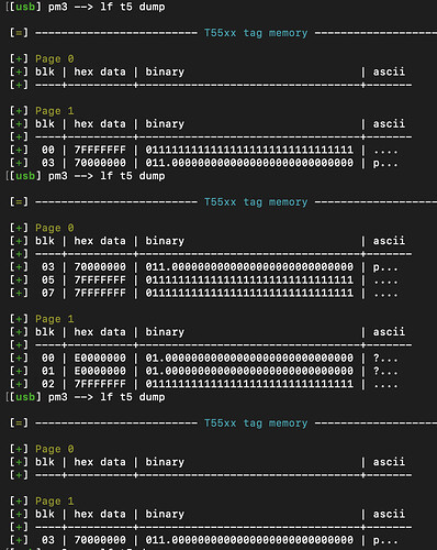

This is what it looks like if I try to dump multiple times.
Is this a good sign that there’s still hope?

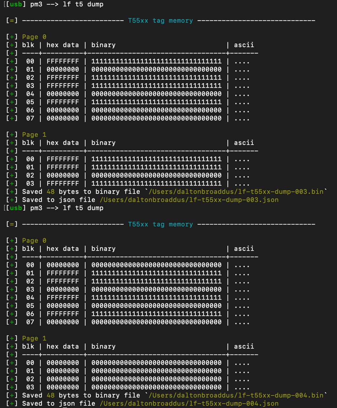

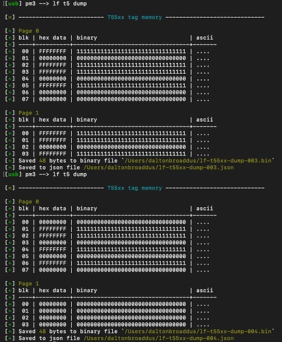

edit: The dump does change. I’m not sure if I am just not getting a good connection, but my implant is really close to my skin and I’m not moving after running
lf tune
you can see here, the dump changes each time. this is after running the -t commands, with 0 movement from me between dumps.

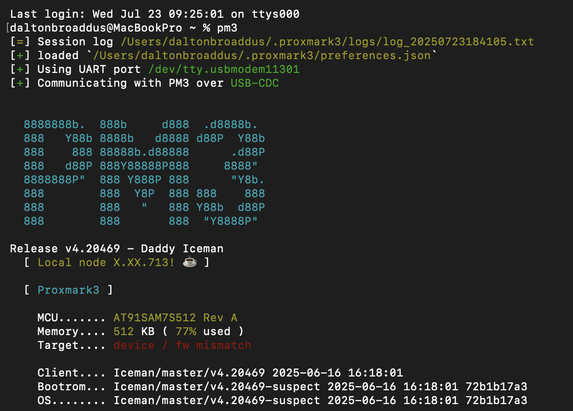

oh wait… let’s just check the most obvious thing… send a screenshot of your promark client startup data (what shows when you run pm3).

see that red text? can you copy / paste the entire output of the startup screen text?
Here’s the entire output:

MCU....... AT91SAM7S512 Rev A
Memory.... 512 KB ( 77% used )
Target.... device / fw mismatch
Client.... Iceman/master/v4.20469 2025-06-16 16:18:01
Bootrom... Iceman/master/v4.20469-suspect 2025-06-16 16:18:01 72b1b17a3
OS........ Iceman/master/v4.20469-suspect 2025-06-16 16:18:01 72b1b17a3
[usb] pm3
huh odd… expected more data… ok well whatever… basically your stuff is compiled for the wrong hardware. the iceman branch defaults to the RDV4 hardware platform, and this red text is telling you the hardware does not match the firmware / client you’ve got… this will cause a kind of proxmark dementia when it comes to operation.
this must be fixed before you can rely on your proxmark to work properly.
since you’re on mac… eh i need someone else familiar with mac to cover how to fix this.
  • what hardware do you actually have?
do not fear, I have it on my windows as well. I am on a Proxmark3 Easy V3.0
