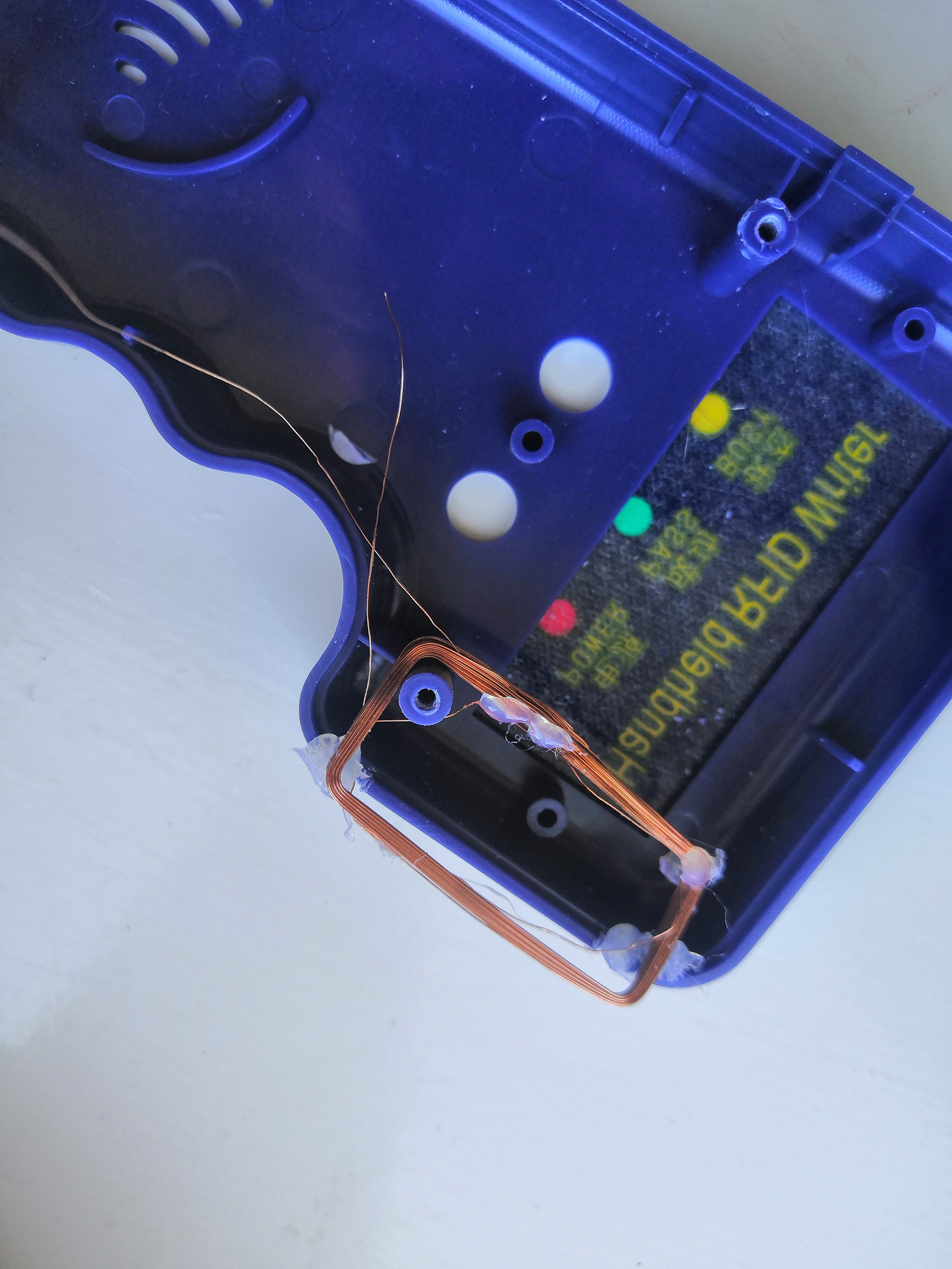

It didn’t read my NExT so I dived right in to modifying the antenna as I have seen others do here. That glue they use is pretty tough so I reached for the mini blowtorch to soften it up. Antenna went a bit squiffy and burnt but never mind I got the bugger out. I start playing around with the loose pcb out of the case reading and writing fobs and trying to read NExT. I noticed lots of orange light but no green. Suddenly I realise that I have been repeatedly pressing the write button instead of read like some kind of demented ape. Mild disappointment sets in as I become convinced that I have bricked it. Now old blue wont read the NExT and barely picks up my practice fobs. Burnt plastic, wires and loose screws everywhere. I honestly don’t even know what I was trying to achieve. I think I have inhaled a lot of solder fumes throughout lockdown.

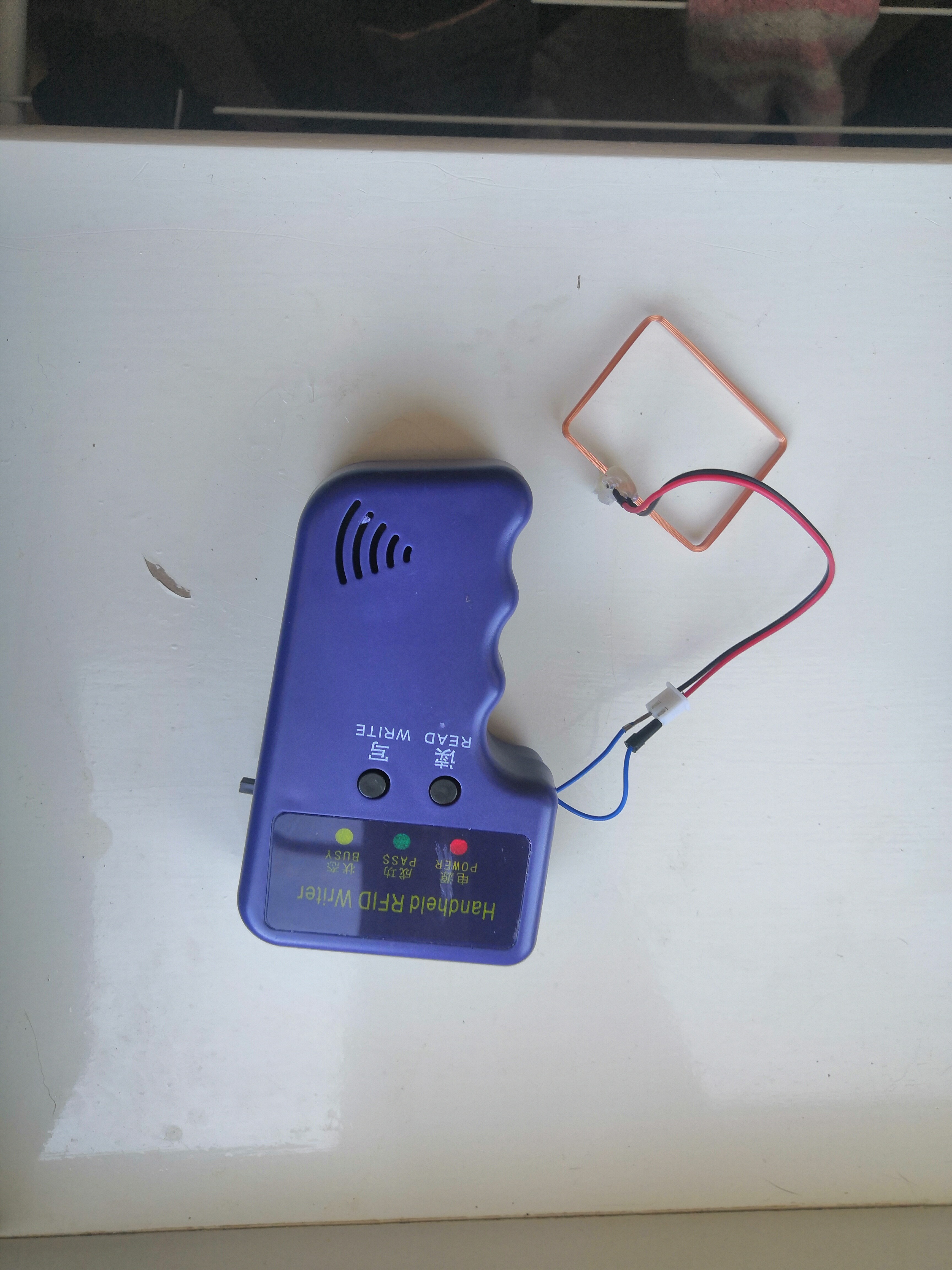

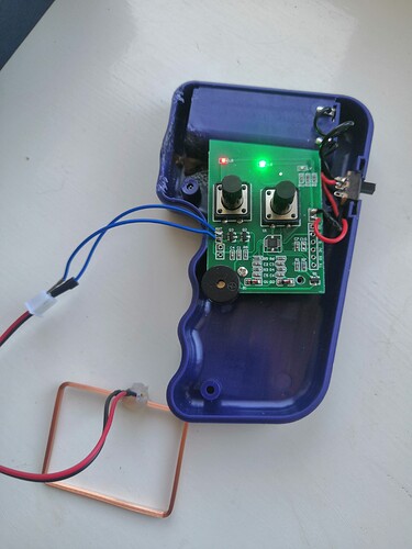

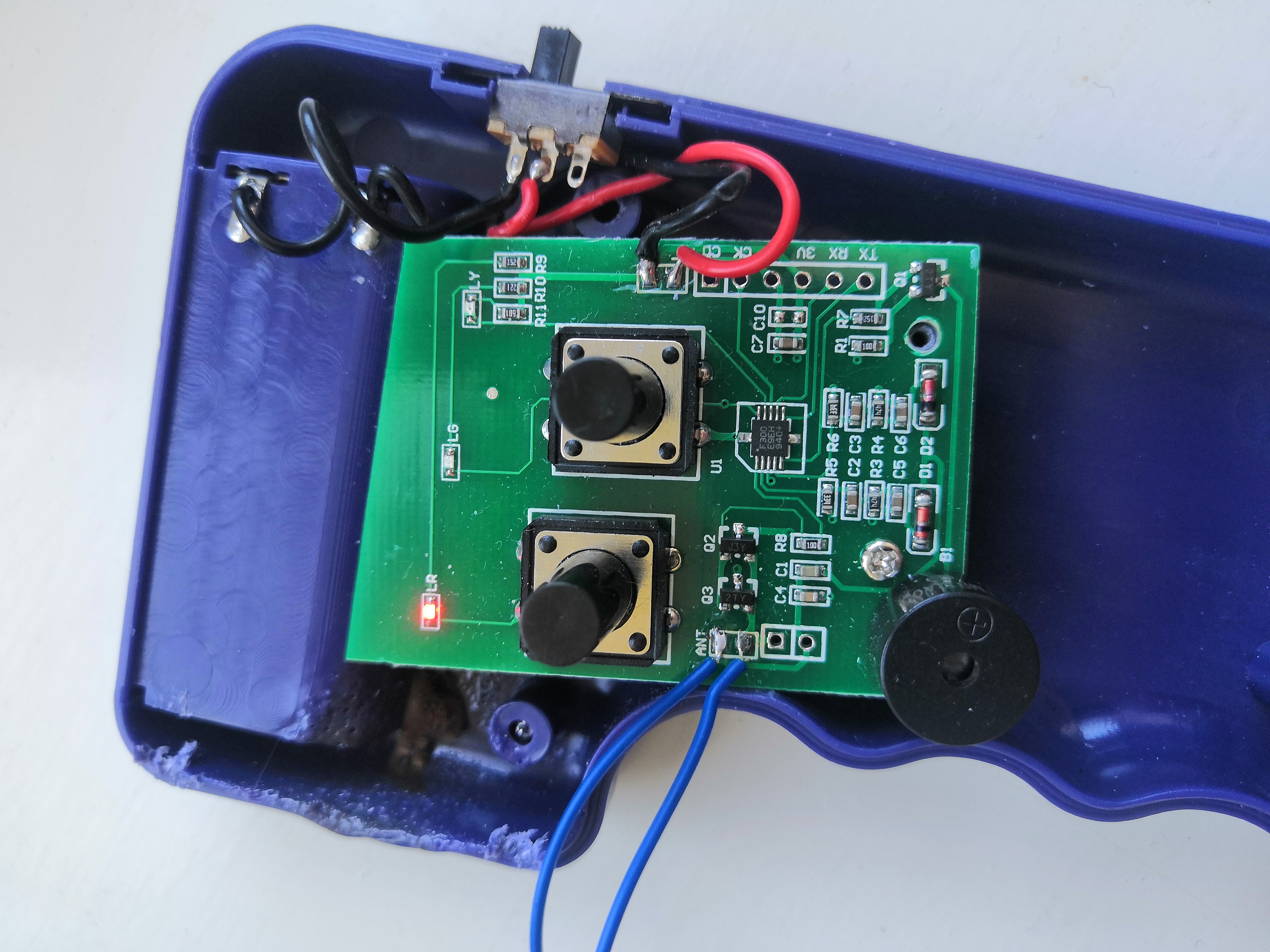

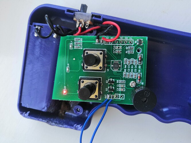

Nevertheless I embark on a mission to try to get it sorted with nothing much to lose at this point. The blue cloner is in a right mess and by now not reading anything. I figured I must have burnt the coating off the wire, causing it to short so I pulled the old burnt antenna off and soldered some jumper wires in its place. Then I plugged in the antenna off the rdm6300. I honestly didnt think this would work but to my surprise it functions beautifully. I read and wrote to some practice fobs with ease confirming on the arduino. Then I tried writing to the NExT and it also worked, as confirmed by the rdm6300. Now I’m dual frequency happy again. Here are some pics of my modded blue cloner that I will probably never use again.
I thought I should pass on this accidental modification and the idiotic story that resulted in its creation.
