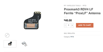

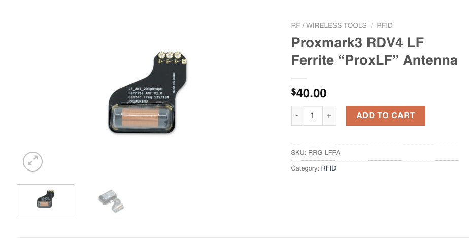

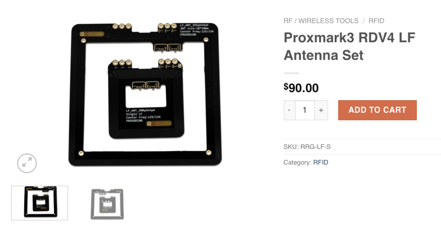

Hi! I’m thinking of upgrading to the RDV4, but I’m not sure which antenna to buy. Does anyone have experience with either or both of these non-stock antennas for the RDV4?
I know that a separate antenna is not necessary, but it seems like it would be useful? I saw some posts mention that the original stock antenna has weak signal even with the q-switch.
I previously bought a PM3 Easy prototype antenna from another user here. Similarly, if anyone has any prototypes or project antennas for the RDV4, I’m all ears!
Also if anyone is willing to let me buy, rent, or borrow any of these (RDV4, ProxLF, or LF Antenna Set), plz lmk! It would be great to briefly test it to see if it’s right for me. I’m in Texas.
Where did you guys buy your tools? These screenshots are from Hacker Warehouse (official distributor). Another site called ’ Red Team Tools ’ has it for cheaper. Is it necessary to purchase from the official distributor?

If you had to rank the 3 antennas (stock, ProxLF, LF Antenna Set), how would you rank them? The LF Antenna Set has a long-range antenna that looks large (and the description says ~133mm range), so I’m assuming stronger antenna? But then, the ProxLF seems to be more focused and tight coils, so I’m not sure if that’s better? The ProxLF is also $50 cheaper, so I wonder if it’s not as good?

Just to make sure I’m understanding correctly, you’re saying that from worst to best is: Stock Antenna < ProxLF < LF Extended Antenna right?

Based on my observation that’s correct.

p.s. this is with proxlf antenna
