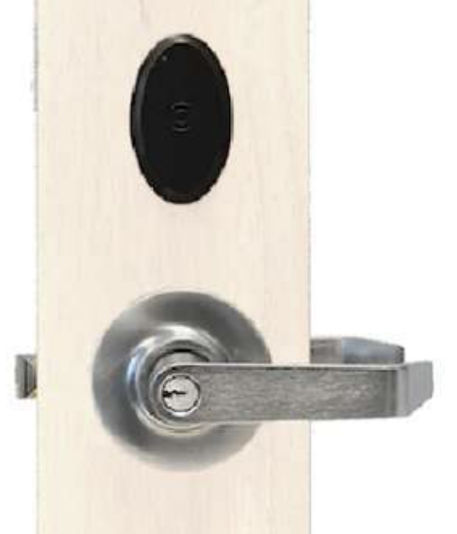

For reference, here’s a stock photo of the cheap thing I had to install on my office door. It runs on four AA batteries. Sorry for the terrible quality, I couldn’t save the image and had to screenshot & crop instead.

So, installation required drilling a hole through the door behind where the reader is mounted for a cable to connect it to the control box, then there’s another wire that goes from the control box down to the metal body inside the lock mechanism. Fortunately they provided a plastic plate that had a channel for this wire, and it didn’t need more drilling to get it to where it needed to go. I can take better pictures of the one on my door when I get to the office tomorrow. Not sure of the brand, but I can find that out as well.

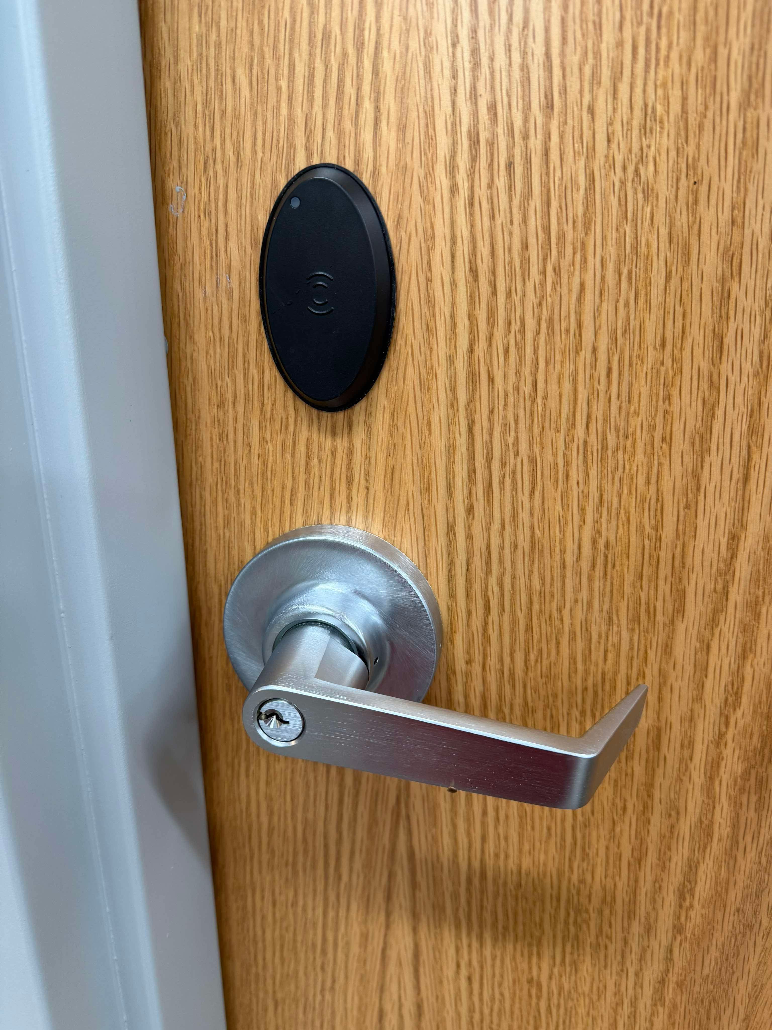

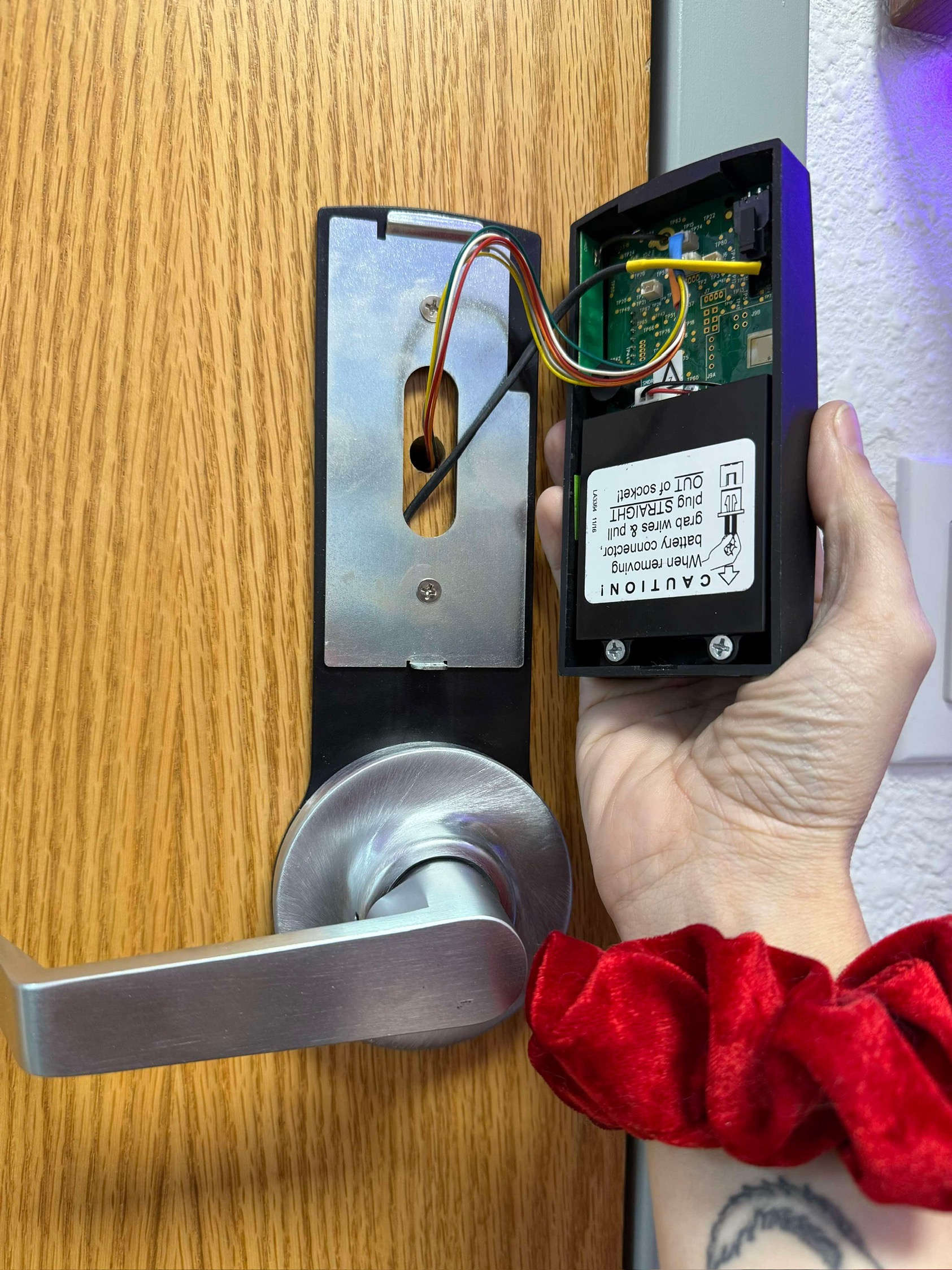

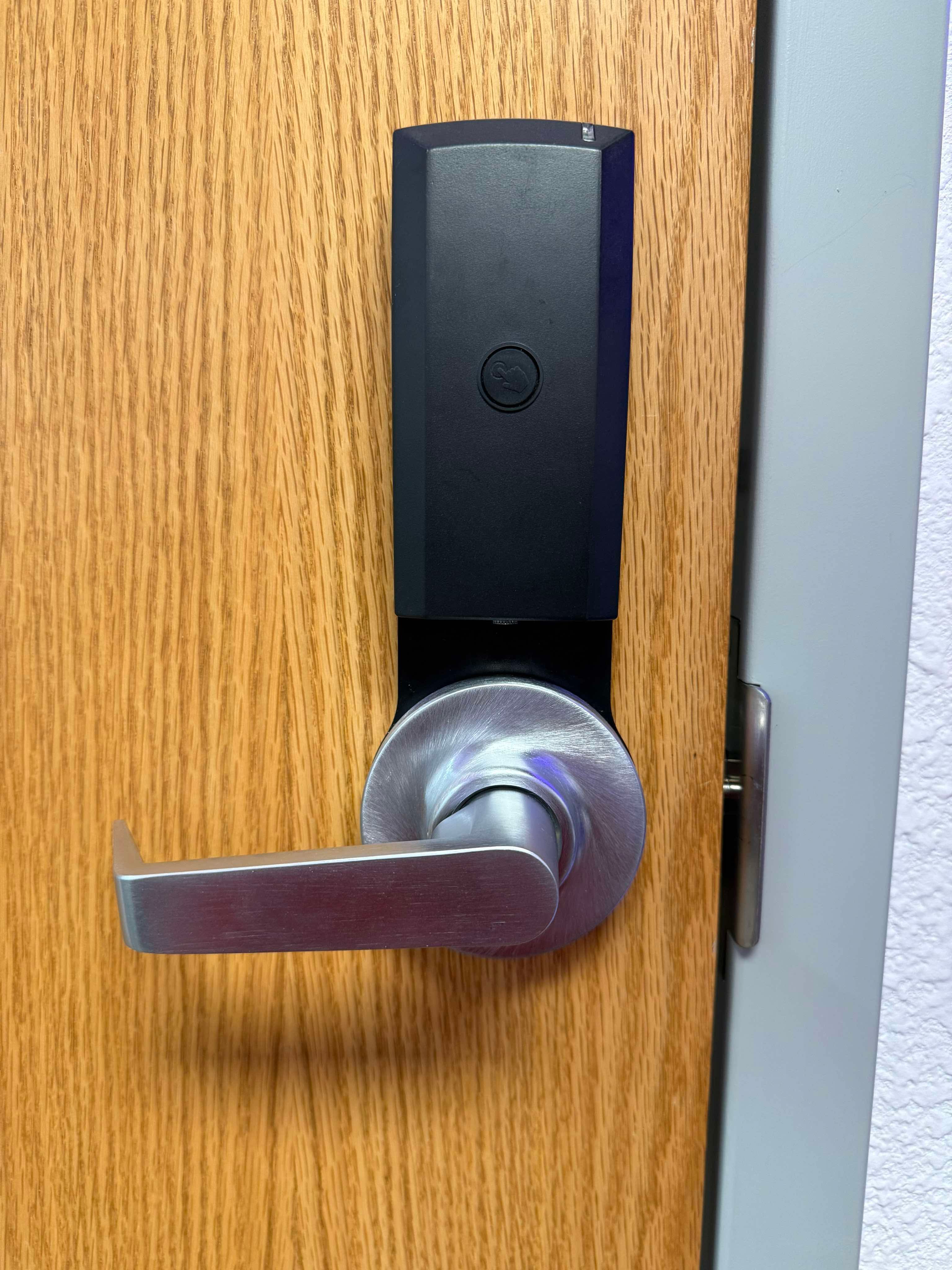

As promised, here are some pics of the lock on my office door. I also have a few videos of how easily my implant reads as well, but my phone isn’t cooperating so I will have to post those from my computer in a bit.
Exterior:
Interior:
Internals:

Wow. And it reads so well. I am really surprised with that given it is battery powered. From the videos, it doesn’t look like it runs any low power cycles or needs to be woken.
