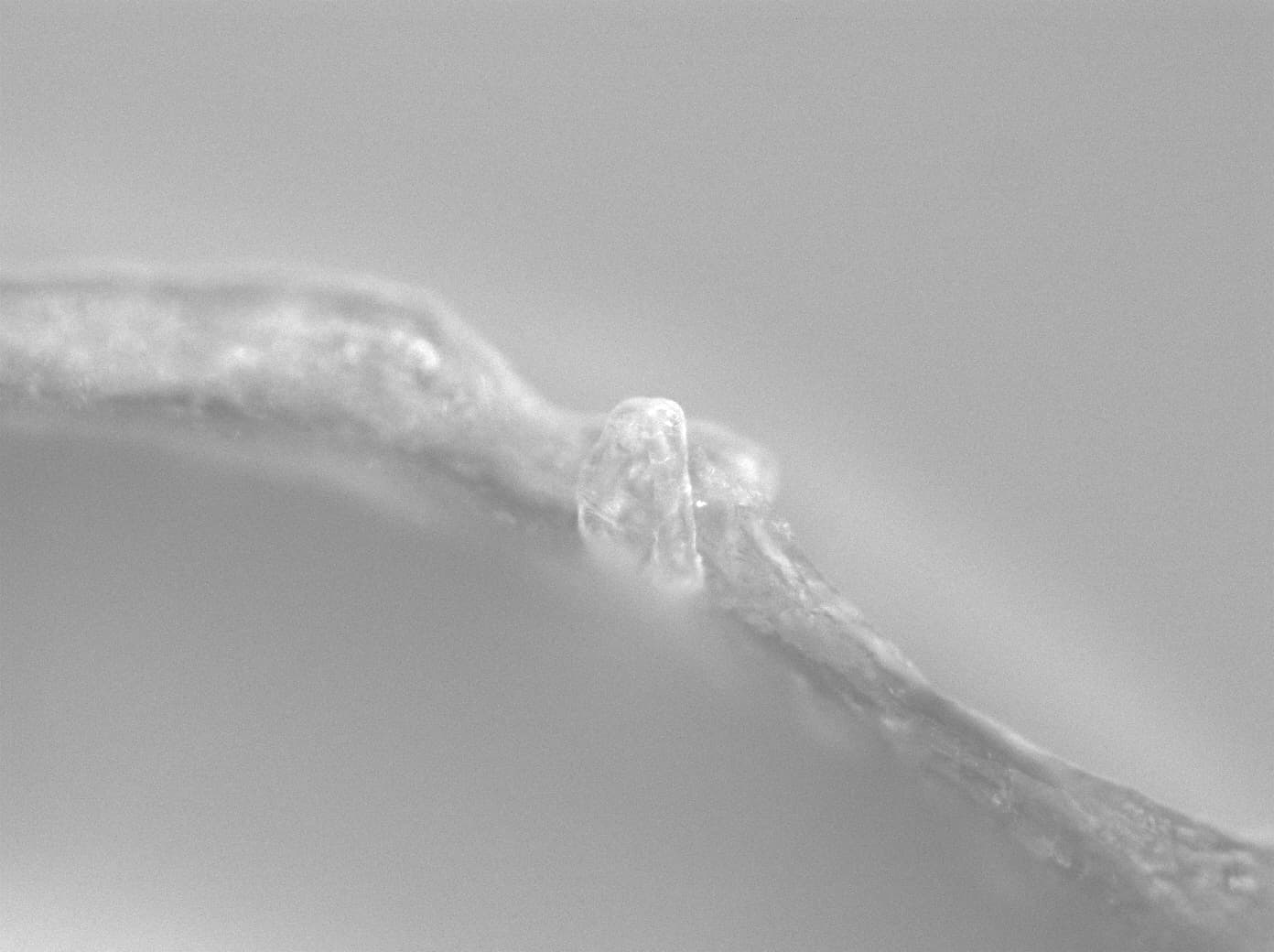

For silicone the important aspects of “long term implant grade” are the lack of contaminants, which takes a lot of effort during manufacturing. To give you an idea, “food grade” actual food has defined allowable levels of things like plastics, rodent hair, animal feces, etc. When it comes to manufacturing materials for the medical industry, entirely closed processes (no open vats, pipes and fittings properly cleaned and flushed between batches, etc.) is very difficult and expensive, but it produces materials with the least amount of external contamination.
In addition to external contamination there is chemical contamination - the remnants of reactants used in processing the material which never got fully extracted and remain in the material. These are also generally very hard to remove, so you will see even lab grade chemicals with levels of purity in the 90% - 99% range… very rarely 100%.

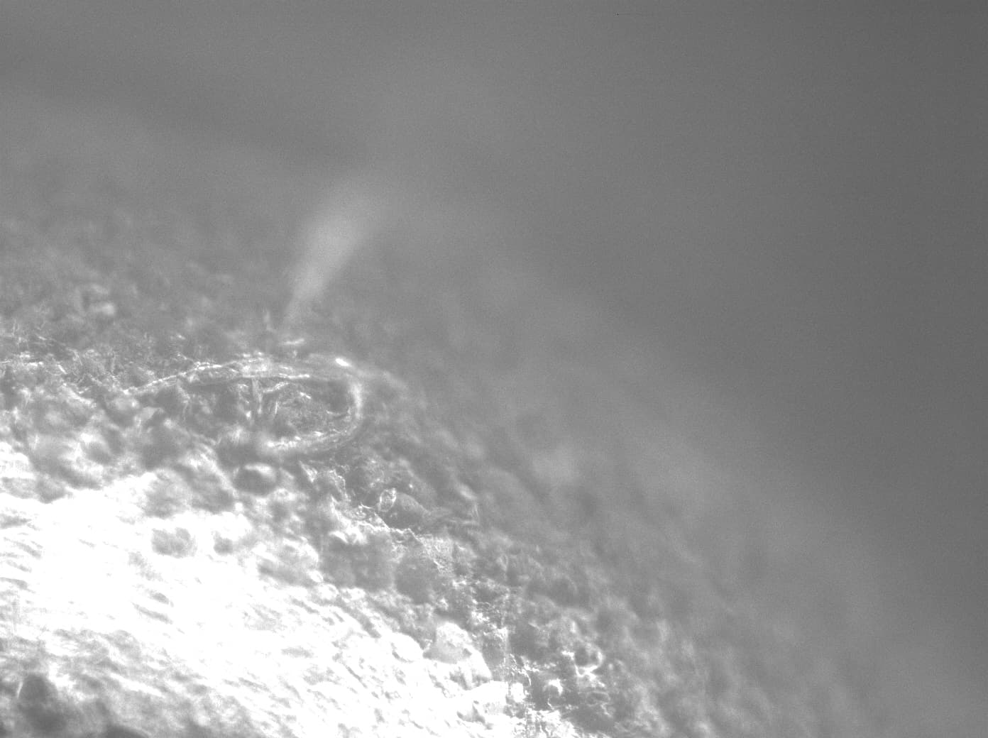

Working with silicone elastomer to be used for implantation purposes also requires some considerations when it comes to surface quality. For example, using a bad mold or mold release process will leave the surface of the silicone which contacts the body in a state that is rather porous and “flakey” for lack of a better word.
The subdermal placement of these implants offers some protection against these surfaces biofouling, but it is important to consider if you are producing devices for implantation.
