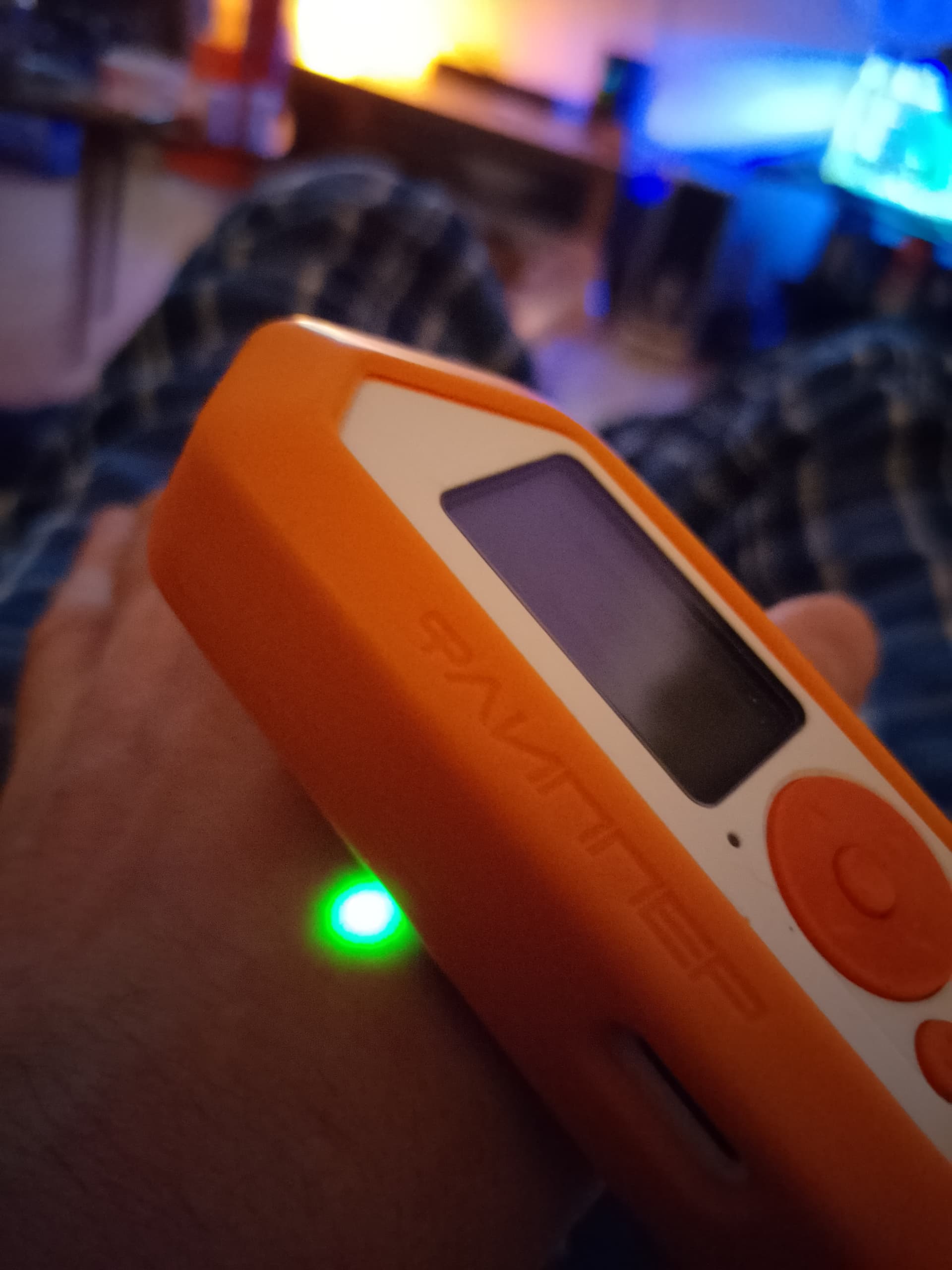

The NEXTv2 is my first NFC/RFID implant, and I couldn’t be happier with it. I had been thinking about getting an implant for years, and just happened to revisit Dangerous Things on the exact day they announced the NEXTv2. I took it as a sign and immediately added it to my cart. I received the implant, and got it installed 4/14/25
From my research, I knew the read/write range could be affected by swelling for the first few days—personally, the swelling lasted around 2–3 days, but your experience may vary. Once the swelling subsided, my Flipper Zero had no issues reading or writing to either chip.
13.56MHz (NFC):
The NFC chip works great with larger antennas, like those in the Flipper Zero. I’ve programmed mine to link to a website, and it reads and writes reliably using the Flipper. That said, performance with my iPhone 16 Pro is a bit spotty—I suspect this is due to the smaller NFC antenna in the phone. It does work, but only in a very specific position: the top of the phone must be perpendicular to the implant and pressed against the skin. This isn’t an issue with the implant itself—just a limitation of phone antennas.
125kHz (RFID):
I cloned my work fob to the 125kHz chip, and it’s been rock solid. It scans easily with the RFID readers at my workplace, likely because those readers have larger antennas. I use it every day and can count on one hand the number of times I’ve had to reposition my hand to get it to scan. It’s been very reliable for daily use.
Overall, I’m extremely satisfied with the performance of the NEXTv2. It’s been dependable, practical, and a great conversation piece. I’m thinking about getting an xMagic next!
If you’ve got any questions, feel free to reach out!
