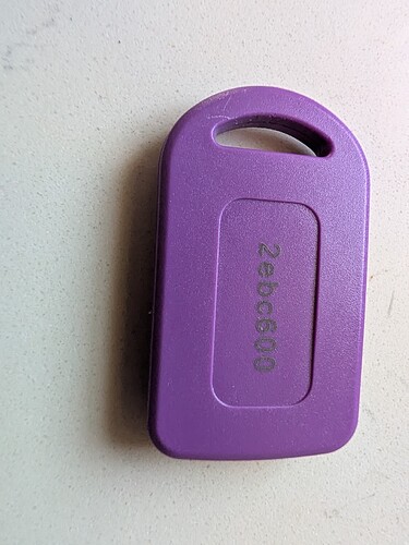

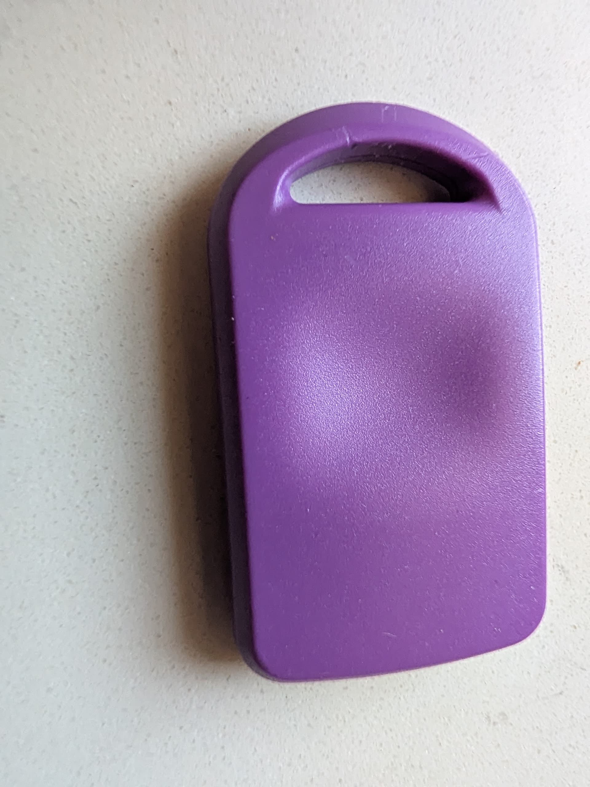

Is this still able to be done? I just got my own key fob and want to make copies of it in case I lose it. I am new to RFID/NFC duplication, so I don’t know much, but I have been reading up on this forum and found this post. I am planning to get a Proxmark3 to duplicate my fob and some low-frequency 125khz fobs based on this thread. And then all I have to do is follow a T55x7 chip guide, a couple shown in this thread, on how to duplicate. Is that all correct?
Attached are pictures of the fob.
In theory this fob should read as a T5577 chipset, which you can lf t5 dump and lf t5 restore to a new T5577.
make sure you lf t55 detect before t55 dumping :wink:
So I just tried this, and I can’t get my PM3 to even read my gym FOB! It did seem to be able to “dump” as a BIN and JSON file were created, but it’s weird that I get the "Couldn’t identify a chipset” error. I tried copying them to a new fod, but when I tried it at the gym, my copy didn’t work. What am I doing wrong? How can I get it to work if the PM3 supposedly can’t read it?
