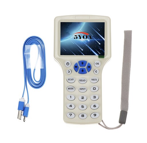

Hi this text topic has kinda been down. Im new to this. Im currently using the iCopy to read and write but it doesnt seem to be reading the AF keyfob. Was thinking of purchasing Proxmark3 but im scared it might not work as well. I would not want to spend another money knowing it might fail again. Someone could enlighten me on this please thank you!
Read this article and this guy manages to copy the RFID of the AF keyfob using keysy. Unfortunately i live in Singapore and keysy is not available in my country.
