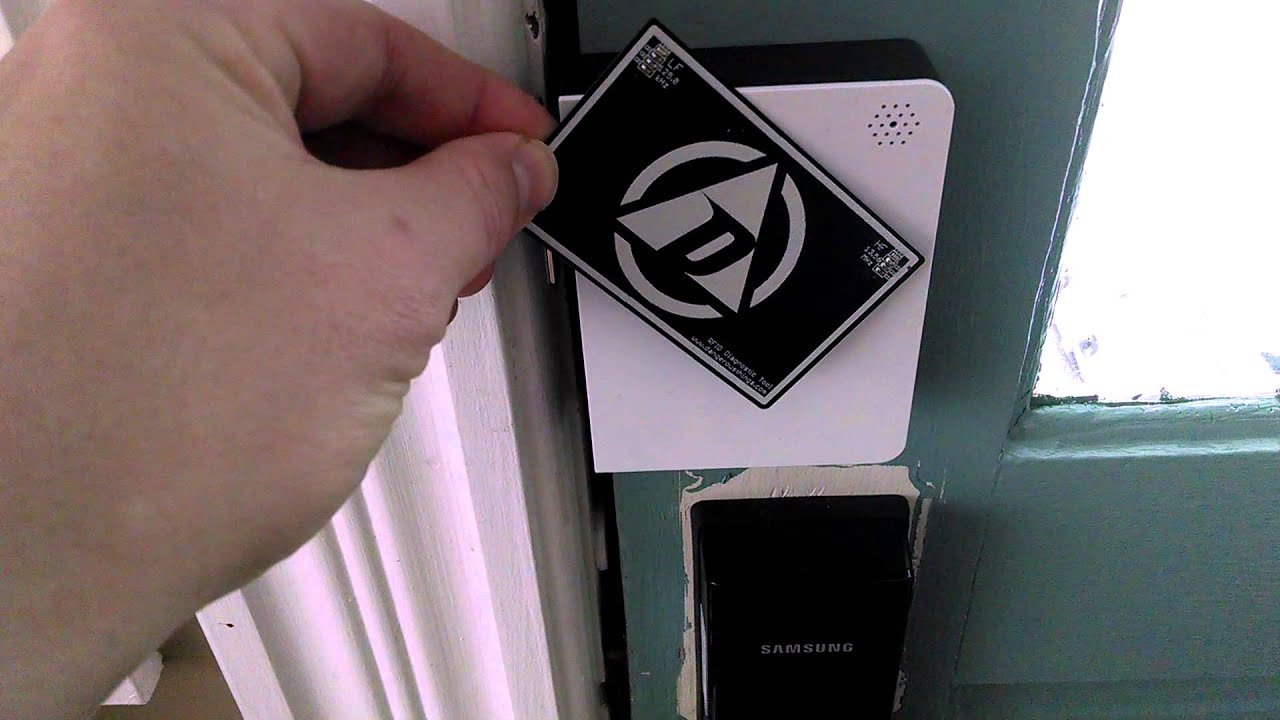

Are we sure they are LF? Could put an RDC up to the reader to check frequency. Anyone shine a light through the silicone looking encapsulation of that purple fob?

What is RDC?

It is a diagnostic card to differentiate between frequencies :card_diagnostic_dt:
