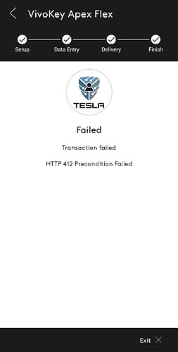

Damit I had been so close in my attempts. I could not figure out the install portion. Having said that I get a failure with those settings. Operation cannot be completed. (Fidesmo.Delivery Error 5.)

its working, we just need to get AID permissions from Fidesmo to deploy. they indicated they had already granted this permission however it was not allowed so we wait for Monday I guess.
I have an Android device and also get the same error when trying to install the Tesla key card app. I’ll try again tomorrow and see if it works.

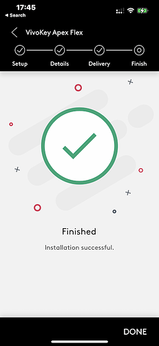

I am happy to say the iOS app is working now. I just installed the NAK applet on my Apex Flex; then paired it with the Tesla. I also found the two sweet spots on the car for unlock and drive.
the ticket support person mentioned they would forward the iOS issue to the front end developers… but something tells me this was a backend problem if it was fixed this fast and without an app update.
